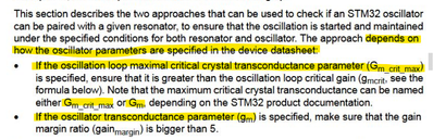

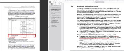

Somehow this is not right, or i got it wrong?
Careful, g_m and G_m are not the same, as the text explains. g_m is not specified in that datasheet.
2 REPLIES 2
My brain put a typo margin in there, so Gm would be gm. ;)
