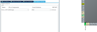

 - Another one can be that you have not configured your FATFS "Detect_SDIO" properly:
And then connect one of the GND pins of the SD module of the detect-pin (PA3 in my case) and the other GND pin to GND.

In STM32H5 there is no Detect_SDIO and there is no FATFS support as well.
I would assume (if you want to have it in your application), you can implement FATFS using this third-party repo:
https://github.com/STMicroelectronics/stm32_mw_fatfs/tree/5042a94556d1c4477642fc6b09450725d18ab5e8
, but I don't know if it will solve your problem.
