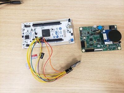

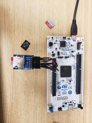

This seems to have been my problem. For the sake of completion here is the before and after if it can help anyone decide on the lengths of cable for prototyping ;)

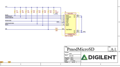

I'm using the PmodMicroSD which has pull up resistors as so:

Before
After
