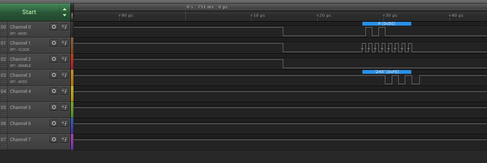

Observe the SCK pin using oscilloscope or logic analyzer.
0693W00000AM1k4QAD.pngHere is the clock, during the first send data,it produce normally, but when to clear the RXNE, it could not produce the SCK.

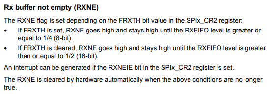

But, I suspect that the hardware automatically, clear the RXNE based on this:
0693W00000AMAYMQA5.pngBut, Im not really understand what this means, can you explain it to me?

RXNE works as a watermark on the Rx FIFO. When a byte arrives, it is stored to FIFO, and it's "level" increments by 1; when your read out a byte from FIFO, it's "level" decrements by 1.
If FRXTH=1, if "level">=1, RXNE=1; if "level" < 1 (i.e. "level" == 0, FIFO empty), RXNE = 0.
If FRXTH=0, if "level" >=2, RXNE=1; if "level"<2 (i.e. there is zero or one byte in FIFO), RXNE=0.
You probably want to have FRXTH set to 1.
