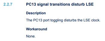

I spent the whole day yesterday trying to figure out the problem with the LSE, attempting to isolate the issue. Then I realized that when I didn't initialize the GPIOs, the LSE worked fine. I'm using the PC13 pin, which has RTC functions and is physically close to the oscillator. Even though I'm using it only as an input, it may cause issues with the RTC.
Later I came across this errata sheet for STM32G030x6/x8 (https://www.st.com/resource/en/errata_sheet/es0486-stm32g030x6x8-device-errata-stmicroelectronics.pdf) that explain the strange behavior with my board.
Right now, I disabled PC13 and uploaded the firmware to several boards for testing. Tomorrow morning, I will test them and come back with the results.

I tested all the boards with PC13 disabled, and none of them exhibited the issue. Consequently, I modified my project to use a different pin instead of PC13. Multiple boards were tested afterward, and they all functioned correctly.

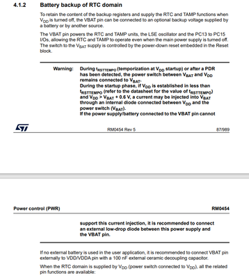

Is that possible to know VDD and VBAT values ?  and how the switching is managed from VBAT to VDD.
During the switching phase of VBAT domain to be powered by VDD the switch is connected to VBAT

@STOne-32 The VDD is about 3.290V and the VBAT is 3.245V. The tRSTTEMPO max is 400us and i have a 1uF capacitor on VBAT.

Is the above VBAT voltage stable, doesn't it drop when VDD is off, or at the moment of VDD startup?
