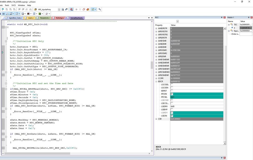

What's the content of RCC_BDCR?

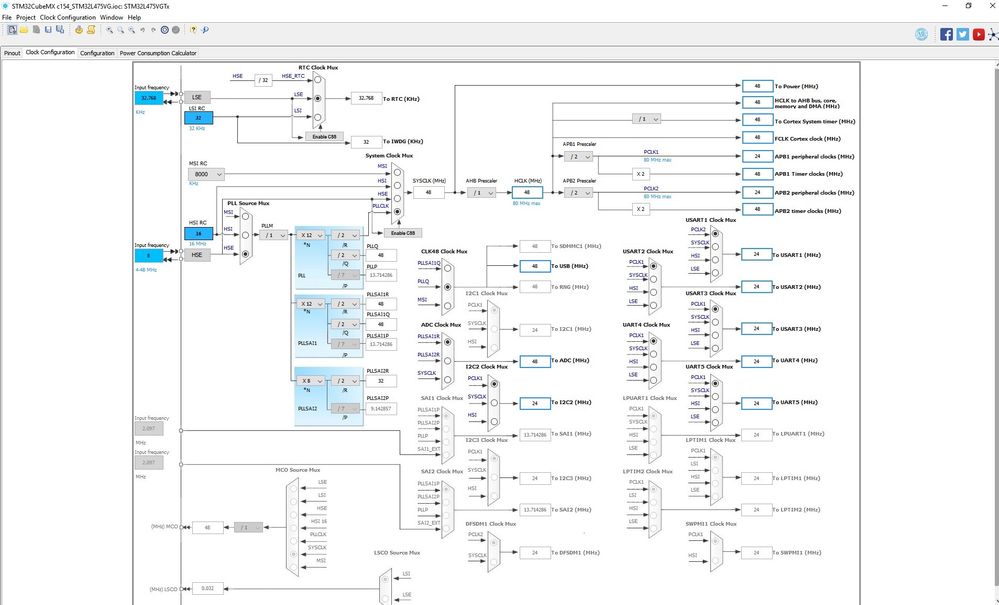

‎2017-08-29 8:20 AM
Here you have a screenshot (debugging session) showing this register as well as the initialization code and a second image where Cube clock configuration is also shown.
Best regards.

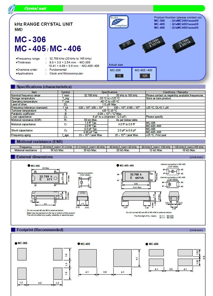

‎2017-08-29 10:23 AM
It is a 6pF crystal.
Please, find enclosed its datasheet.
Furthermore, I have already modified LSE Drive to 'Higher Driver Capability' and result is the same....
Best regards.

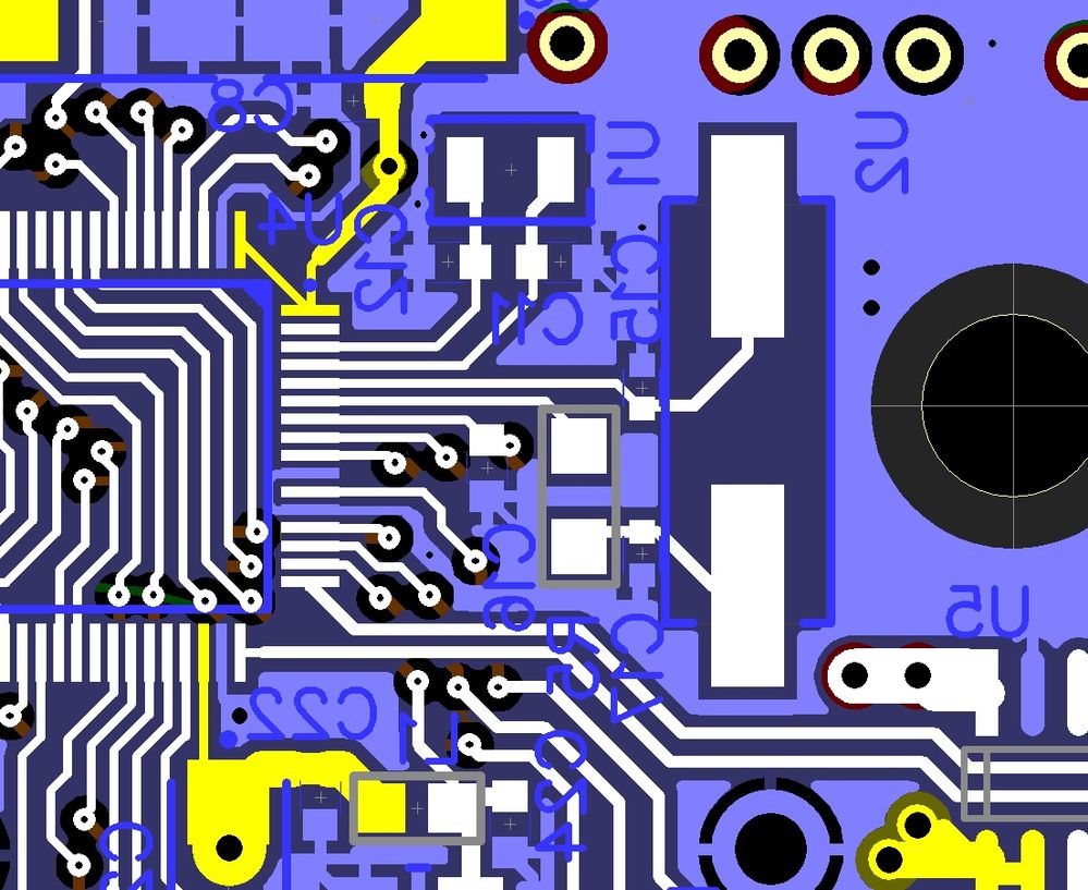

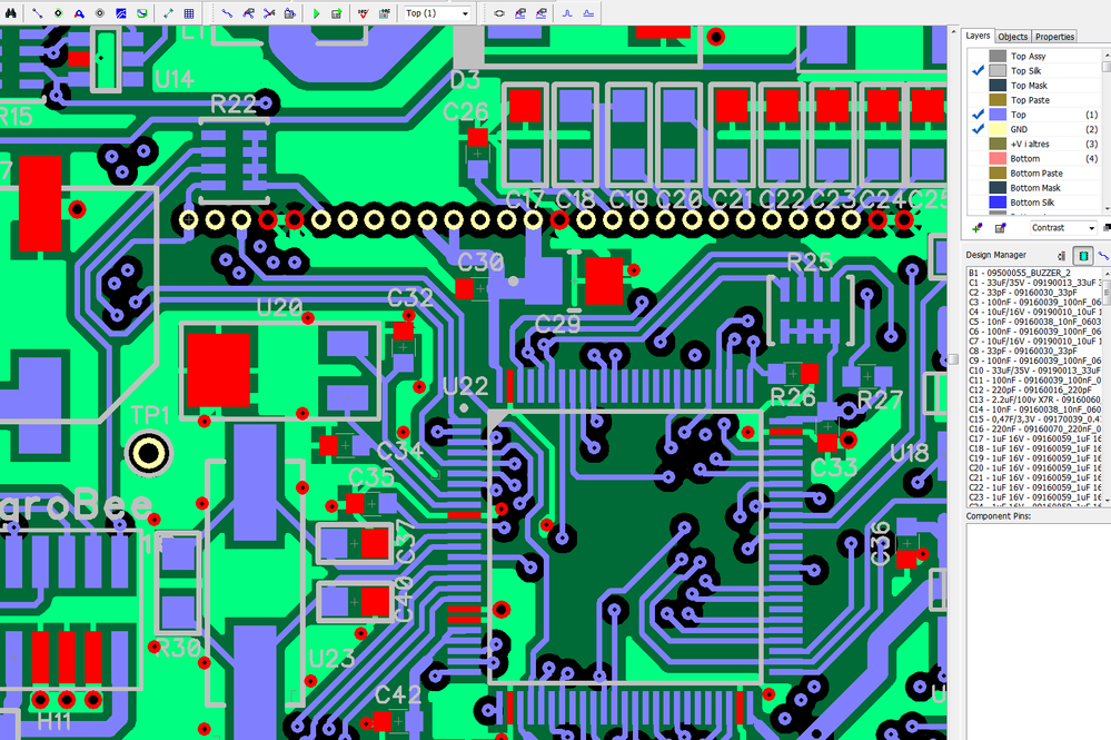

I summarize here below our current status with this issue:
- For the pcb we have been talking about, we have sensed LSE frequency (pin PA2) and read frequency is about 32.518KHz.
- We have just received a different pcb (based on same micro) and we have tested it: in this case, the read frequency at PA2 pin is correct. Being in this situation, we have also enabled PC13 for the 512Hz calibration output --> this makes the PA2 to be 32.5KHz and PC13 is about 508Hz. In the same situatiuon, if 512Hz output is mapped to PB2 (instead of PC13), then we get 32.1768KHz (PA2) and 512Hz (PB2). So, it seems that PC13 is coupled with crystal IN/OUT when it is enabled as a calibration ouput.
Apart of this, and in order to guess what it is happening with the first pcb, please find here below a screenshot of both pcbs: the one we have been talking about and the second one, where crystal is working fine. What is your opinion?
Best regards,
Dani.
‎2017-08-30 6:41 AM
VBAT is routed how?
