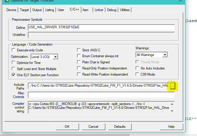

Hi

‎2017-08-29 12:10 PM
Hello Ted
Go to Project options ->C/C++ tab->Include paths and add new paths to your include directories

‎2017-08-29 12:44 PM
Example uses the original SPL (Standard Peripheral Library), not the HAL/Cube libraries.
http://www.st.com/en/embedded-software/stsw-stm32054.html
Download, bottom of page

‎2017-08-29 4:13 PM
I installed STSW-STM32054
I think I need to change #1 to #2 but how ?
________________ Attachments : change.jpg : https://st--c.eu10.content.force.com/sfc/dist/version/download/?oid=00Db0000000YtG6&ids=0680X000006HyTI&d=%2Fa%2F0X0000000b8C%2FBkJ2PqPQ7W_25thIN3BipFBdzuXD1bjY5BJrnu1gqkM&asPdf=false- Mark as New
‎2017-08-30 9:27 AM
>>I think I need to change ♯ 1 to ♯ 2 but how ?
What do these refer too?
You'd want to replicate one of the project templates for your donor project, and then paste in code from the example into the 'main.c'.
You shouldn't need to pull in the separate peripheral files, usually these come in via stm32f10x.h, and stm32f10x_conf.h and the define USE_STDPERIPH_DRIVER
