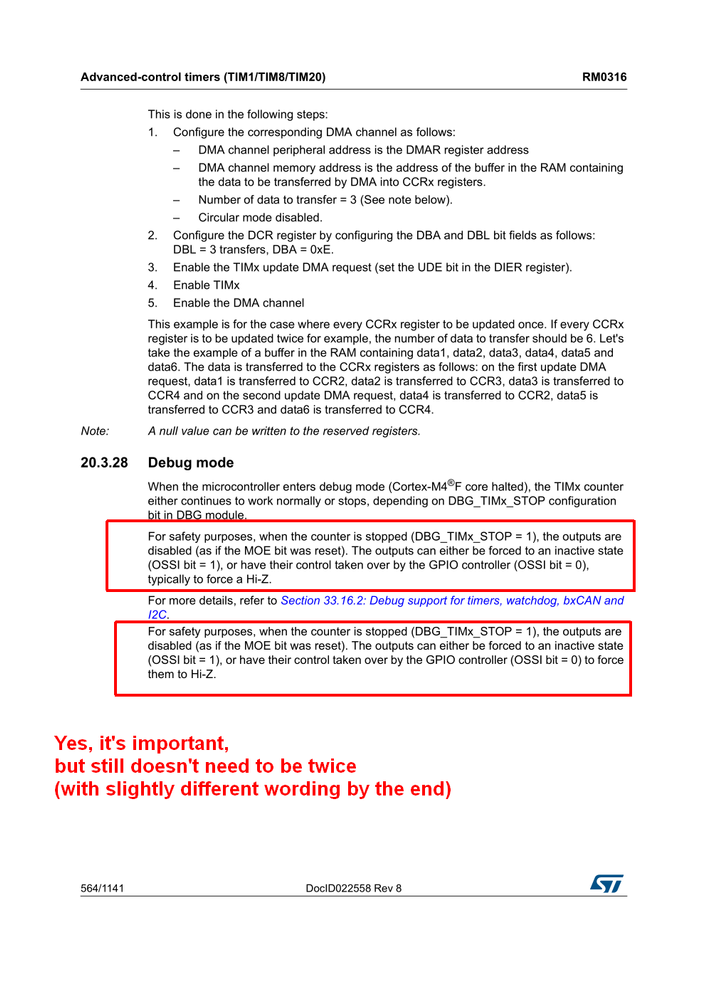

0693W00000aHK8NQAW.pngGiven the surprising combination of these two RMs, I'm quite willing to bet there are more RMs out there with this.
Nonfatal, but still.

Hi @Community member​ ,
Thank you for reporting this typo.
I will check internally.
This typo will be fixed in the coming RMs versions.
Thank you.
