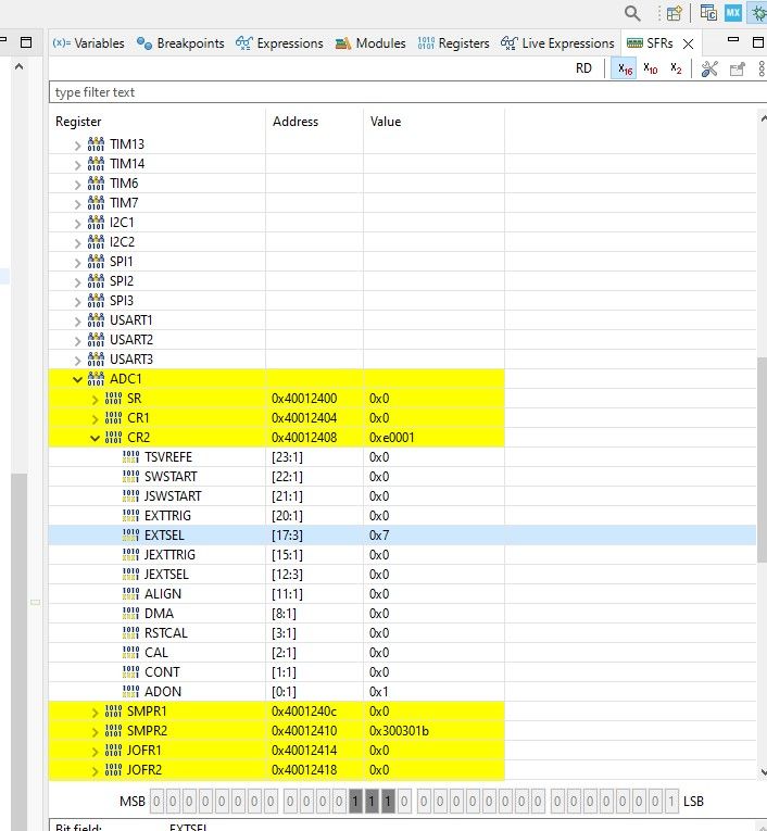

Still troubleshooting here, I tried to abandon the SWSTART as a trigger, and just used ADON:
void adc_start(void)
 ADC1->SR = 0; //Clear status register
// ADC1->CR2 |= ADC_CR2_SWSTART;         //Does not work
// ADC1->CR2 |= ADC_CR2_SWSTART | ADC_CR2_ADON; //Does not work
 ADC1->CR2 |= ADC_CR2_ADON;           //Works
I also removed the second write to ADON in the config function. Now getting successful conversions (EOC is being set as expected). So... it now works, but I do NOT know why it wasn't working before. I confirmed in the debugger that the EXTTRIG bits were set to all 1s (which per the RM, should be for SW triggers).
To recap: the latest code (included here) is successfully triggering conversions. When I try to do it with SWSTART instead, it does not. I cannot explain why.
waclawek.jan
If any other bit in this register apart from ADON is changed at the same time
waclawek.jan

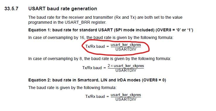

So... I've made the jump to an STM32G081 (on an eval card). The advice I received was correct -- while similar, there are enough differences to make the software significantly different. I have successfully set up my clock tree and blinked some LEDs (at expected rates - hence why I think the clocks are correct). I believe the UART clock is 64MHz. I am dividing it by 8 (I think) to get 8MHz for my usart_ker_ckpres. I am now [again] trying to get USART tx to work. I am able to successfully transmit one character. However, I am not receiving anything after that. II think it has to be something with how I am checking "tx done" flags, but I can't spot it. Any advice would be much appreciated.

I'm not sure what you mean by "kick out the timeout". I inserted some lines to turn on LEDs if various timeout conditions occurred, and they were not being executed. I eventually solved the problem:
USART3 on my chip (STM32G081RBT6) only has "Basic" functionality. Per Table 180 in RM0444 (p. 1001), the "Basic feature set" does not include a prescalar. So my BRR was in fact, set incorrectly. Because I am configured to oversample by 16 and I thought I had set my prescaler to divide my clock by 8 (from 64MHz to 8MHz), it must have somehow worked out that I was getting the first character transmitted (maybe combining iterations? I'm too lazy to do the math to figure out). In any case, by now knowing my actual clock is 64MHz (not 8MHz), I adjusted my BRR:
  //USART3 has basic functionality - no prescaler
  //Set baud rate to 115200 (OVER8 = 0, oversampling by 16)
  //    USARTDIV = Fclk/BR = 64MHz/115200 = 555.56 = 556 = 0x22C
  USART3->BRR = 0x22C;
And now my USART is transmitting normally (as expected) and I see everything in my terminal window.
You mentioned previously it is more elegant to calculate the baud rate in the code rather than hard code it. Could you give an example?
waclawek.jan
I personally would revert to the non-working code to find a definitive explanation, why one byte got transmitted even with incorrect BRR setting, but YMMV.
​By "kick out" I meant remove.
#define SYSTEM_CLK 64000000
#define USART3_BAUD 115200
USART3->BRR = (SYSTEM_CLK +(USART3_BAUD /2)) / USART3_BAUD;
constants are folded (computed) at compile time, i.e. this computation is "free".
JW​
SHobb.1
Why do you add the "+ (USART3_BAUD/2)"?
The formula on p. 1017 of RM0444 just shows:
0693W00000NrRTXQA3.jpgDoes constant folding still work with functions like "round" or "ceil"?
Could I do something like:
USART3->BRR = (UINT32_t)round(SYSTEM_CLK/USART3_BAUD);
waclawek.jan
Strictly speaking, compilers are not required to perform constant folding in expressions outside certain situations, e.g. initializers, bitfield width declarators etc. But it would be foolish from even the most rudimentary compiler not to do so with expressions which are evaluated to be used in plain assignment to volatile variable, and do conform to requirements for the special usage outlined above (constant expressions, C99 6.6), so it is generally expected to be the case.
However, introducing floats and function calls is outside of strict requirements for constant expressions. Compilers still may evaluate them compile-time, but whether they do, and what exactly is the outcome (we are here talking about the minutiae of floating-point, such as rounding of mantissa) is compiler-dependent.
The "+ (USART3_BAUD/2)" is there to perform the rounding entirely in integer arithmetics.
