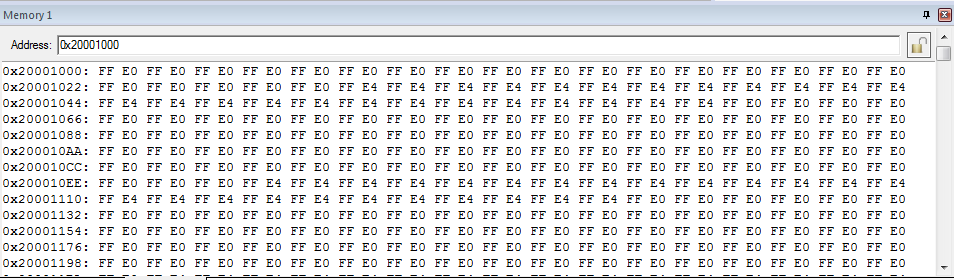

SOME_ARRAY after power off then on.

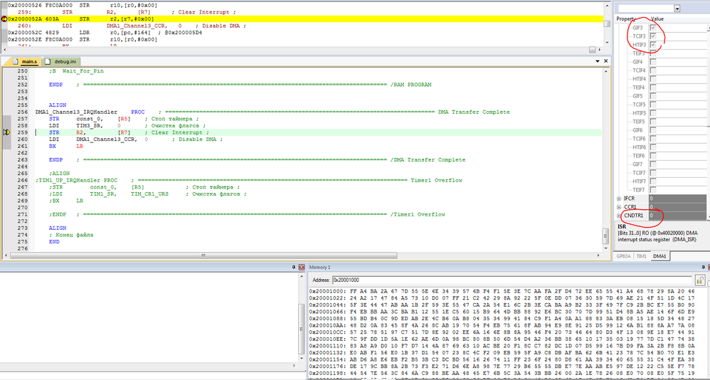

SOME_ARRAY after DMA interrupts program flow (without WFI).

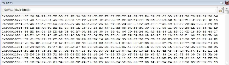

SOME_ARRAY after DMA interrupts program flow (with WFI)
All flags are set (GIF, TCIF, HTIF), data counter is zero. But there's no data in SOME_ARRAY.
I just comment and uncomment WFI command.
