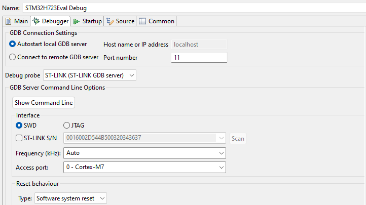

I'm trying to do the same, debug two target boards at the same time when both are running. How to set the debug port number to make it connect to the different board?

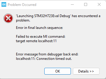

0693W00000aJgBwQAK.pngWhen I change debugger configuration by using the port number from Port COM 10 or 11, I'm getting connection error

Select ST-LINK S/N with the scanned value can find the right board now.

Open one end in an instance of the IDE. Under Debugging, select a specific serial number for the STLink you're using, easiest to do is to configure the system with only one connected, but do not choose "auto". You need to have a specific serial number matching the STLink you have connected to the current project. You don't care about which serial port is emulated.
Open the other end in another instance. Select the other STLink by its serial number/ Things related to one end will be in the appropriate instance. .
