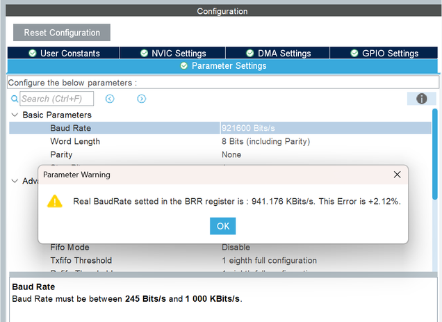

Depending on your clock speed, setting for 921600 doesn't mean it's exactly 921600. If you play with the clock especially with a high baud rate, sometimes CubeMX/STM32CubeIDE will give a warning that there is an error greater than some %.
There could still be a slight % error, but CubeMX may not give a warning if it's under a threshold? I'm just assuming about the threshold, so take that with a grain of salt.
Since you're using TeraTerm, i assume you're using some USB-Serial adapter. That adapter too, could have a % error.
Maybe check with a scope to see if indeed both devices are exactly 921600?

i have uploaded now
The higher the rate, the less well it will divide into the Peripheral Clock, but it's not a cumulative error, on the Rx side it should be resyncing/framing based on the bit centers.
I would not however be sending megabyte, or multi-megabyte, packets across a async serial connection. Protocols like XMODEM-1K were developed to allow for flow-control and integrity in file transfers. Certainly what I'd use to push firmware updates, and allow for write to FLASH internal or external, or eMMC / SDCard
I didnt get an % error considering my configuration, i think the problem that the my Programm dosent handle the data properly while the communication baudrate is too fast and the data is big
