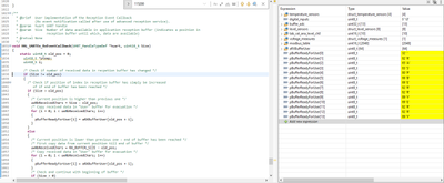

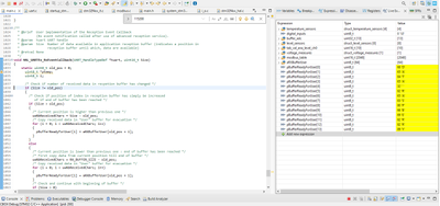

I just put this example.
My data are well received in aRxBufferUser (it's the DMA's buffer).
The final data that I want to bring back are located in pBufferReadyForReception or pBufferReadyForUser, I'm not sure.
If I take a look in these values, values are moving, because for me, if I look pBufferReadyForUser[0], the data must always be the character 'D', but in live expression, it changes at each time.
fab04
I was looking the different values.
1st time : RPI sends a frame, µc receives it. Size = 14 (IT from idle)
2nd time : RPI sends a frame, µc receives it Size = 15 (IT from HT), uwNbReceivedChars = 1, copy of one character in pBufferReadyForUser[0],
then new IT (IT from idle), Size = 28, uwNbReceivedChars  = 13, but the copy starts also with pBufferReadyForUser[0], so the first character is deleted.
if (Size != old_pos)
	    /* Check if position of index in reception buffer has simply be increased
	       of if end of buffer has been reached */
	    if (Size > old_pos)
	      /* Current position is higher than previous one */
	      uwNbReceivedChars = Size - old_pos;
	      /* Copy received data in "User" buffer for evacuation */
	      for (i = 0; i < uwNbReceivedChars; i++)
	        pBufferReadyForUser[i] = aRXBufferUser[old_pos + i];
	    else
	      /* Current position is lower than previous one : end of buffer has been reached */
	      /* First copy data from current position till end of buffer */
	      uwNbReceivedChars = RX_BUFFER_SIZE - old_pos;
	      /* Check and continue with beginning of buffer */
	      if (Size > 0)
	        for (i = 0; i < Size; i++)
	          pBufferReadyForUser[uwNbReceivedChars + i] = aRXBufferUser[i];
	        uwNbReceivedChars += Size;
RxEventCallback gets called on IDLE event but also on HT. This is what is happening.
