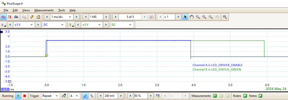

Colleagues,
Here’s a code snippet which changes the state of two GPIO lines with delays in between.
[My actual firmware has more code, and I’ve reduced it to this condensed example which still has the issue.]
HAL_GPIO_WritePin(LED_DRIVER_ENABLE_GPIO_Port, LED_DRIVER_ENABLE_Pin, GPIO_PIN_SET);
HAL_Delay(1);
HAL_GPIO_WritePin(LED_STATUS_GREEN_GPIO_Port, LED_STATUS_GREEN_Pin, GPIO_PIN_SET);
HAL_Delay(1);
HAL_GPIO_WritePin(LED_DRIVER_ENABLE_GPIO_Port, LED_DRIVER_ENABLE_Pin, GPIO_PIN_RESET);
HAL_Delay(1);
HAL_GPIO_WritePin(LED_STATUS_GREEN_GPIO_Port, LED_STATUS_GREEN_Pin, GPIO_PIN_RESET);
The resulting picture on the oscilloscope looks quite wrong.
oscilloscope screenshot of GPIO outputsoscilloscope screenshot of GPIO outputs
Legend for the oscilloscope plot:
Channel A is LED_DRIVER_ENABLE (PA3)
Channel B is LED_STATUS_GREEN (PB0)
The most troubling part is that the LED_STATUS_GREEN goes up before LED_DIVER_ENABLE on the oscilloscope.  In the code LED_DIVER_ENABLE precedes LED_STATUS_GREEN.  [It's more visible in my update below.]
In addition, the first call to HAL_Delay(1) produced a 0.1ms delay instead of expected 1ms.  The second and third calls to HAL_Delay(1) produced 4ms and 2ms delays.
What could be causing these issues?
Any suggestion, insight or reference is really appreciated!
STM32G474. I ran the code on two copies of the board, and the microcontrollers are from the same reel.  I see the same anomaly on both of them.
The compiler is CubeIDE v1.15.1 . The optimization is -O0 (no optimization, which is the default setting).  Let me know if I should provide more information.

(you know of course that HAL_Delay(1) can take any time from 1 to 2 ms ? )

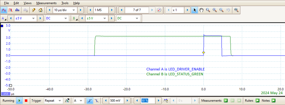

Here's an even more condensed code for this issue.  I removed the delays, but the GPIO outputs are still out of order.
Channel A is LED_DRIVER_ENABLE (pin PA3)
Channel B is LED_STATUS_GREEN (pin PB0)
time axis in [microseconds]
edit:  Here's the disassembly.  I'll have to read-up before I can understand it.

Does one of the GPIOs "gate" the other? So that one cannot raise until the other is in high state?

As @Pavel A. said above, a minimum-1ms-time-wasting-delay with 1ms granularity can take 2ms, and it does, if it is invoked two times in a row.
My guess is that you set LED_STATUS_GREEN in the code you haven't shown us, before the snippet you've shown us.
Place a breakpoint - or infinite loop - just before that code and observe LED_STATUS_GREEN.
gbm
Principal
Make sure to set the scope to CHOP mode (not ALT).
