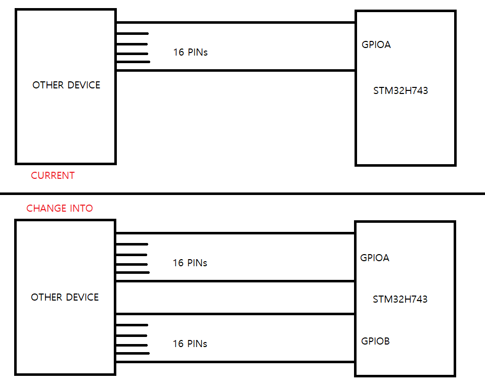

I'm currently using STM32H743 and I'm trying to Read Data in multiple GPIOx_IDR register
Previously, I was using 16 bits and trying to change into 32 bits for IDR.
When I debug, I could find correct data on SFRs -> Register -> GPIOA -> GPIO_IDR with below code.
previous code
main.h
#define my_data_Pin (0xFFFF) // Use all PA0-PA15 pins
#define my_data_GPIO_Port GPIOA
otherfile.c
void read_my_data(uint16_t *pbuf)
*pbuf++ = (uint16_t)my_data_GPIO_Port -> IDR;
Now, I'm not sure how to define the code for using all PA0-PA15 pins & PB0-PB15 pins for 32bit data.
 0693W000006E7baQAC.pngI've tried something like below, but it didn't work.
#define my_data_Pin (0xFFFF) && (0xFFFF)
#define my_data_GPIO_Port GPIOA && GPIOB
Could somebody help me out with this please?
Your help will be highly appreciated.

Since your array is of uint16_t, just do two operations:
*pbuf++ = GPIOA->IDR;
*pbuf++ = GPIOB->IDR;
The cast to (uint16_t) isn't hurting anything but it's not necessary.
This will require two operations. Trying to do something like GPIOA && GPIOB is nonsense.

You can't do them at the same time. The CPU only does one instruction at a time. You could combine them into the same C statement, but it still won't occur at the same time.
*pbuf++ = (GPIOA->IDR << 16) + GPIOB->IDR;

Well... I was sending data from other devices to MCU via 16 pins at the same time.
ex) 0000 0000 0000 0101
Then, when I debug, I could read the value 0x101 from below.
This kind of process wouldn't be possible for 32 pins, right?
