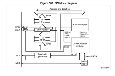

First time i set up SPI, not using HAL.
In the debug, i see that not a single bit is set.
What am i doing wrong?
 SPI_HandleTypeDef spiHandle;
  spiHandle.Instance = SPI2;
  // SPI_CR1_CPOL
  SET_BIT(spiHandle.Instance->CR1, SPI_BAUDRATEPRESCALER_256);
  // CPOL = 0
  SET_BIT(spiHandle.Instance->CR1, SPI_POLARITY_LOW);
  // CPHA = 1
  SET_BIT(spiHandle.Instance->CR1, SPI_PHASE_2EDGE);
  // MSB is default
  // We are Master
  SET_BIT(spiHandle.Instance->CR1, SPI_MODE_MASTER);
  // Active SPI
  SET_BIT(spiHandle.Instance->CR1, SPI_CR1_SPE);
  // Frame length
  SET_BIT(spiHandle.Instance->CR2, SPI_CR2_DS_2 | SPI_CR2_DS_1 | SPI_CR2_DS_0);
  // SS output
  SET_BIT(spiHandle.Instance->CR2, SPI_CR2_SSOE );
This is the solution:
SET_BIT(RCC->APB1ENR1, RCC_APB1ENR1_SPI2EN);
It was not mentioned in the SPI instructions...

I rather like to read it in the manual, but i must have missed it? I followed the procedure in it.
Also there a so many places where it the solution would be.
I could set up the uart easily.
G4xx SPI is not so complex :
Maybe easy way: setup with Cube, then just write to DR ( SPI2->DR ) , as i do, to send.  :)
