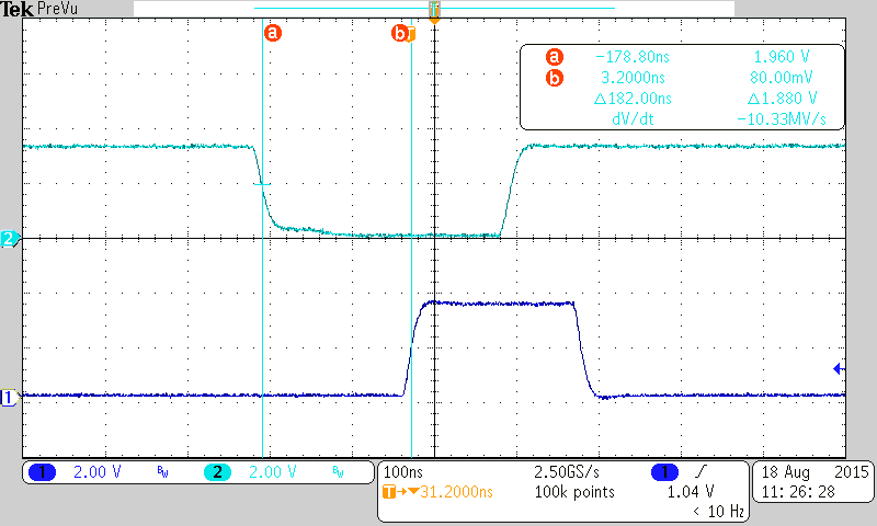

No, i mean HSYC is falling indicating blanking, at this moment that is 300ns long. So i must disable DMA, reconfigure DMA with new address and and enable DMA, so it will fill new line to SRAM as it should
Right now my interrupt takes 200ns, but it is shifted by 200ns, because it takes time for CPU to go into interrupt 0690X00000605ITQAY.png No, by the code, i am only doing few functions, so it should be smaller. Can any one help me write this in ASM, so it will be as fast as possible. So far, it looks like this:
> because it takes time for CPU to go into interrupt It should not require 200ns on a fast STM32F4 to enter the interrupt. What is your system clock speed? I will assume 168 / 180 MHz from the part number you mentioned. Cortex M4 interrupt latency is 12 cycles, so that would be 72ns. Be sure to configure your interrupt at the highest priority, so it does not get delayed by another interrupt. I think several parts of your interrupt routine are unnecessary:
  • if() - statement
  • Clearing and setting
    DMA2_Stream1->CR
  • Setting
    DMA2_Stream1->FCR
In fact, if you are careful to ensure that your DMA completes before this interrupt triggers (eg. only enable it after DMA completion), you could disable the DMA when it completes and prepare it in advance, so you only need to activate it in your interrupt:
void
EXTI4_IRQHandler(
void
DMA2_Stream1->CR |= DMA_SxCR_EN;
EXTI->PR = EXTI_Line4;
I think that should be able to complete in something like 100ns. With GCC, you can declare global register variables and do inline assembler with __asm__, but I doubt it will be necessary / useful here. Completing the interrupt in 300ns seems quite possible, I think, with careful C coding. Using double-buffer mode for DMA is generally the best way to ensure continuous transfer, but it sounds like in your case it the timing of when the DMA channel is started is critical?

With only interrupt code running, i have around 100ns free time before HSYNC goes high. only few numbers needs to be written to DMA registers, clearly, it could be done faster than 100ns ?
And i am running at 218MHz clock speed, because any lower, and i will massive errors with DMA buffer. PCLK is 53.3333MHz
