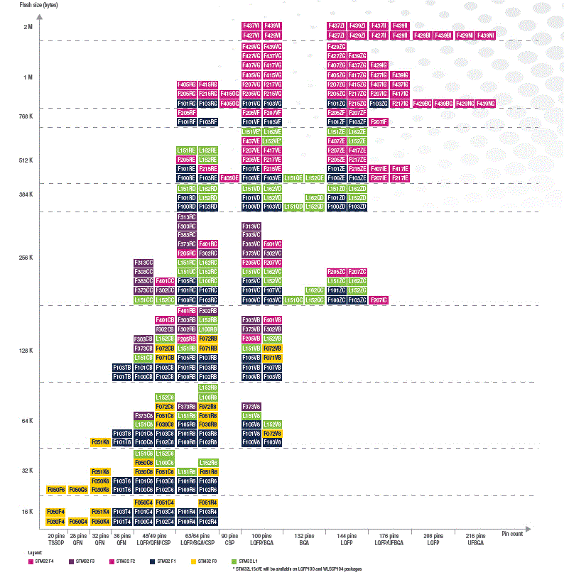

Posted on February 14, 2014 at 18:41
In the context of your question,
Define STM32
Define Very High Speed
The FIFO is there to mitigate memory contention issues wrt source and target devices.

(Although Clive hinted, that the DMA in different STM32 models may differ in details, I don't believe they would differ in this particular one. AFAIK, only the 'F2/'F4 DMA has FIFO).

Posted on February 17, 2014 at 11:23
The model is STM32F205.
With very high speed I mean a peripheral sending bytes very fast. E.g. UART @921600 ( a byte every 10us )
