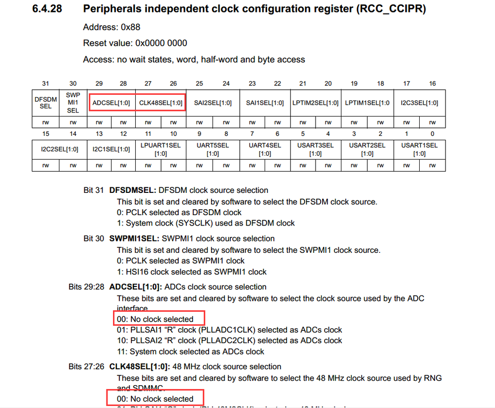

HI,i found that some peripheral can select clock source  by  change RCC_CCIPR.
but both ADC and CLK48M,default clock source is ''No clock selected'',it can work normal also.
why?
