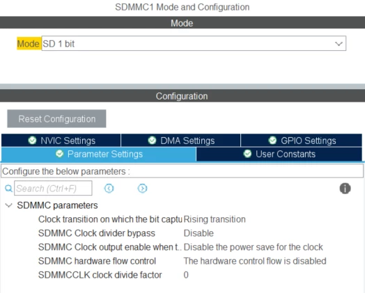

First; I have tried to setup the SDMMC interface with at least 20MHz clock speed (clock divide factor 0)
  • The behaviour is very intermittent. It sometimes mounts, opens, writes, closes, then unmounts, but other times will not open or write without an FR_DISK_ERR. My error handling attempts to correct any errors, but I believe there is no fix for a FR_DISK_ERR right? After a while a Hard Fault occurs.
  • I tried again with 40MHz clock speed and clock divide factor of 4. With these settings it goes for longer without errors, however now and then there are still errors that creap in. After a while a Hard Fault occurs too

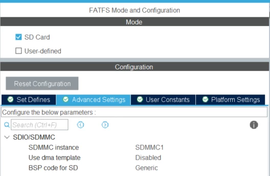

Third; I have tried to enable the DMA transfer using the DMA template in the FatFS settings
  • I won't go into this here (I'll post another question for this later), but at this stage I had no luck with that either. Once I have resolved these other issues I will look more into the DMA. However if any of you know of any resources for using the DMA with the STM32L431, I would really appreciate it. What I did was to enable the DMA template in FatFs, with the DMA settings in SDMMC enabled.

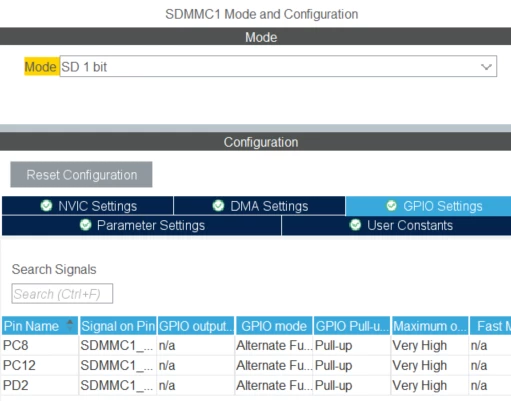

I got it working using 1-bit wide bus, 2MHz clock speed, 0 clock divide factor, FatFs enabled, DMA disabled, SDMMC1 global interrupt enabled.

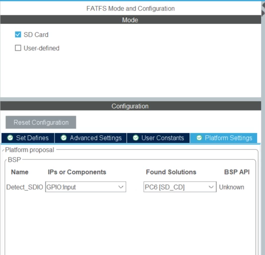

richardnuvetech_2-1698851761049.pngrichardnuvetech_3-1698851800081.pngrichardnuvetech_4-1698851903952.png
The Detect_SDIO pin is selected (in this case input on PC6)

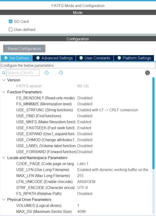

Can you send a picture of your FATFS --> platform settings?

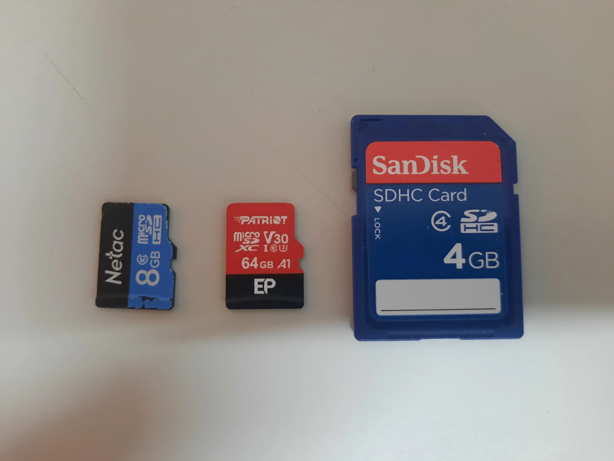

Hi elso,
Thank you for the reply. The cards I have tried are the following:
  • SanDisk SDHC 4GB Speed Class 4
  • Netac microSD SDHC 8GB Speed Class 10
  • Patriot microSD SDXC 64GB Speed Class 10, UHS Speed class 3, Video Speed class 30

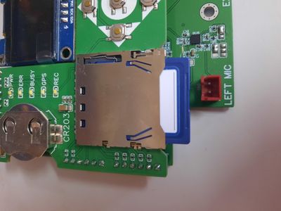

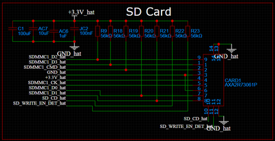

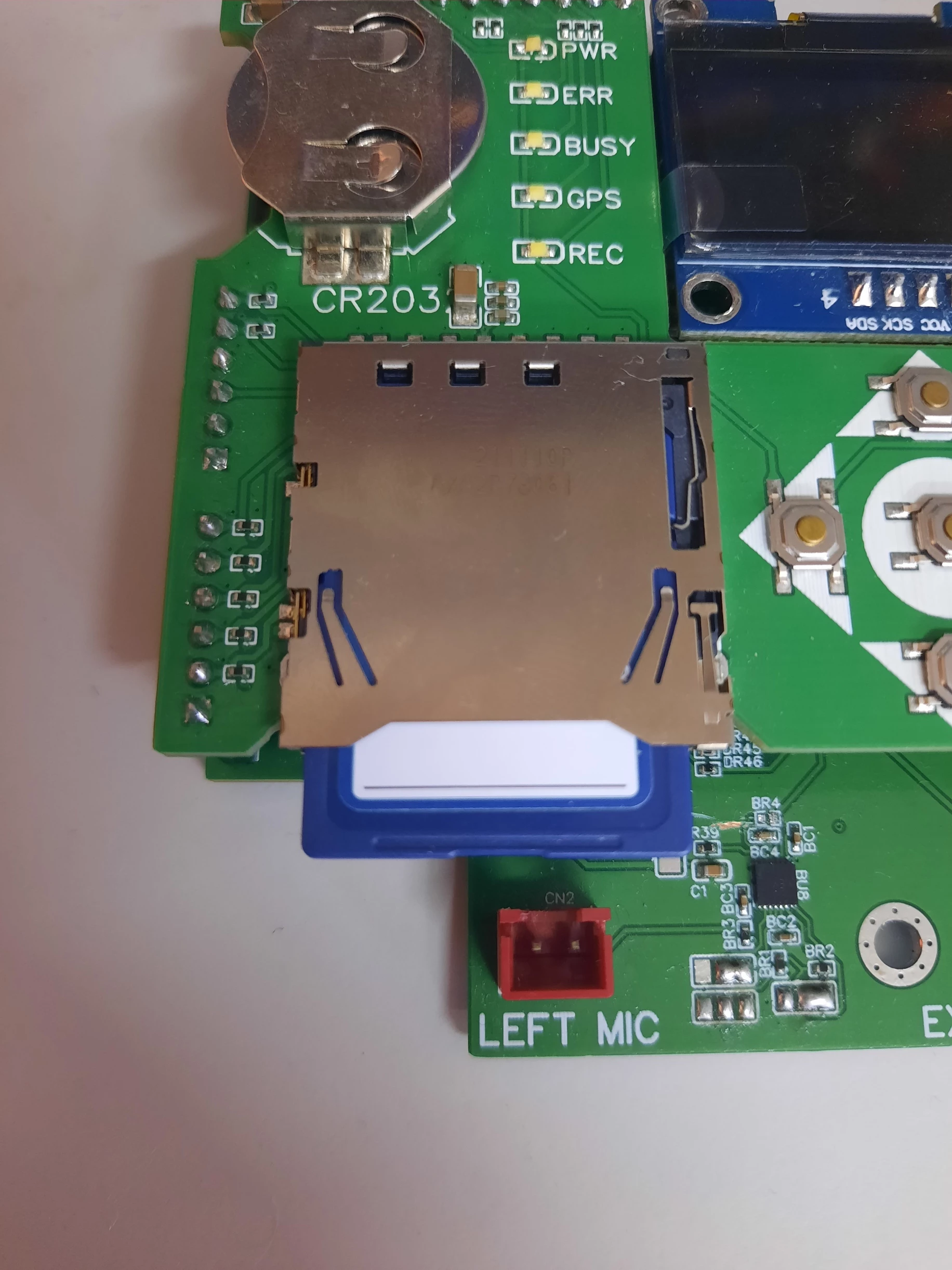

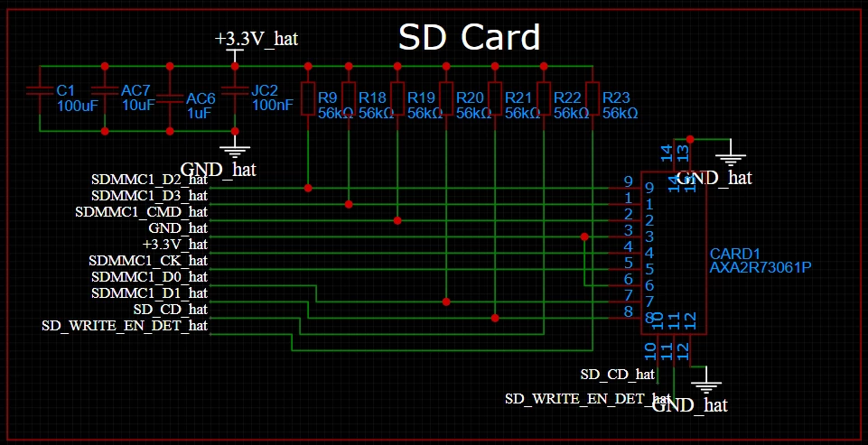

Here are the pictures of the device and SD card schematic:
This board is a 2-tier with the SD card directly above the microcontroller (STM32L431) beneath, with the signals going through pin headers. Trace (and pin) distance for signals to travel is about 5cm.
Another board I have tried, which has the same schematic for the SD card, is a single PCB (not a 2-tiered PCB as shown above), however the distance was about 15cm between the SD card and the micro (STM32L431) which I feel is adding problems to signal integrity.

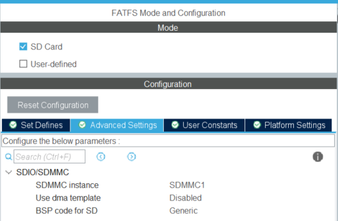

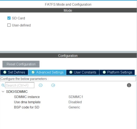

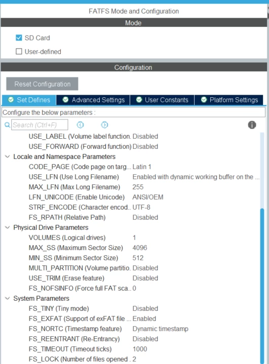

Here are my FATFS platform settings and advanced settings:

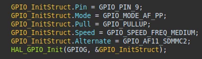

at first, set / use 1-bit mode only; (4 bit mode is more challenging with regard to signal quality )
find stable working setting then. (set pin speed medium or medium-high , not highest! , and pullups on.)
clk should work at 50M. ( i have 100MHz and div1 , so sd-card can work at highest possible speed - depending on card ! )

i had no luck with "dma template", so i never use dma here ; anyway useless, if i/you want to read or write on card and wait for finishing this - useless to have dma , if cpu fast enough for transfer at max speed.

on H563 Cube force speed high + no pullup : -> sd never working.
i overwrite setting in ..hal_msp.c : to medium + pullup :
then sd working fine , with ~ 10 cm flat ribbon wire to sd card holder ! at 100MHz /div1 = 50M clk.
if you have wires, keep them together, both gnd on separate wires connected, and a cer cap at the card holder.
