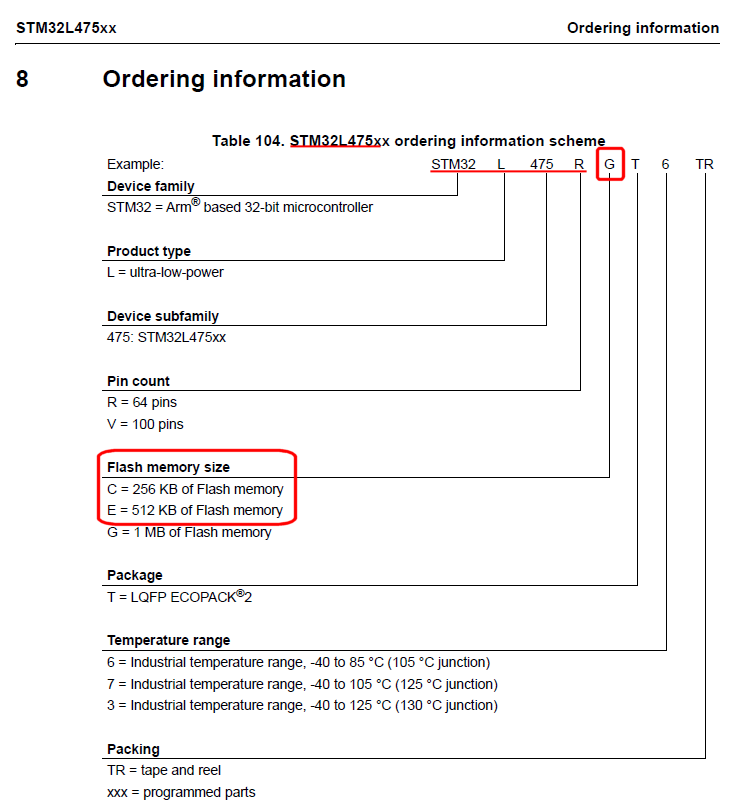

Probably there's no difference between these two two chips, except for the FLASH size.

@Community member​ STM32L475RC and STM32L475RE
So the only difference there is the 'C' or 'E' suffix.
As @Community member​ said, that's just the Flash size - as the datasheet tells you:
"the new project based on the STM32L475RE is not working"
So what, exactly, is "wrong" with it?
