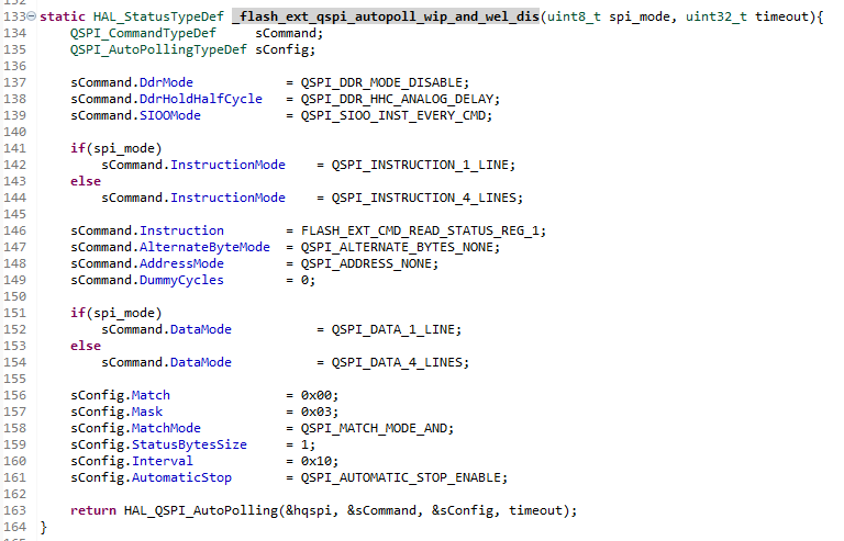

I am trying to autopoll wip and wel bit from status register (0x05) in a flash memory when I perfrom a erase process.

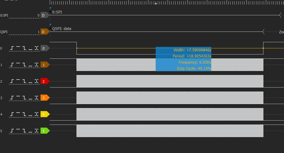

The first autopolling operation is correctly, however, the second time that qspi try to autpoll the bits, this does not release CS, and the data is not readed correctly. I am using HAL_QSPI and inmediatlly after perfrom the aupolling hal line, it finish, but the peripheral continue polling the bits forever.

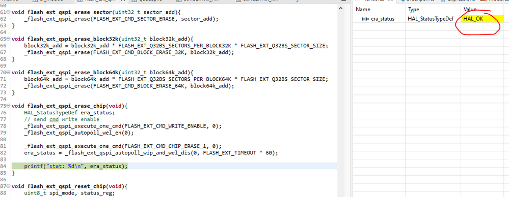

There is not error.
The instruction elapse faster than the polling operation of qspi
polling operation take 7.1seconds but reach printf take less than 1 sec. Timeout is 60sec (FLASH_EXT_TIME_OUT 1000).
And I still doubting about cs not released after the first polling operation. There is not information related to this behavior in datasheet.

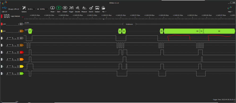

The red marked section (first post) is it retrying, should be able to modulate that width via sConfig/Interval
Why it's not matching is another matter, and may relate to structure initialization. It looks like the code is trying to match something else, or there is some disagreement about modes or patterns.
2022-04-28 8:16 PM
CLK period is 260ns, so interval is 16 cycles (0x10) which give 4.16us, and the logic analyzer match with this separation between lectures.
And also I initialize variables with zero, but the problem still occuring.

The peripheral make a correct polling and stop when the value match after 7sec, however, in fw code this does not wait the 7 sec. I suppose this is a hal bug. I am using Cube IDE 1.9.0 and Cube H7 1.10.0

The logic analyzer plots look very odd for sure, not sure I have a good explanation yet, but pondering..

I made many attempts repeating the capture of data with my logics analyzer, because I though maybe CS wire is not attached well, But in all my captures of data, the result is the same graphic (CS not releasing).

Now, hal_autoplling method wait correctly to the match value (7.1secs).
I change this two lines, from this:
sConfig.Match = 0x00;
sConfig.Mask = 0x01;
sConfig.StatusBytesSize = 1;to this:
sConfig.Match = 0x0000;
sConfig.Mask = 0x0101;
sConfig.StatusBytesSize = 2;Looks like, the minimum size for statusbytesize parameter is 2.
However, my logic analyzer still showing a CS not releasing after first polling.
