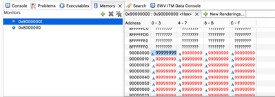

I have a custom board with STM32H747IGT6 MCU, which communicates with a S25HL512TFAMHI010 flash memory chip over QSPI. I have made several iterations of this board, and the QSPI communication has always been fine.
However, on the most recent iteration of the board, I am finding a very strange problem. I am able to erase/program the flash chip with external loader file using STM32CubeProgrammer, and to use this to read the 0x90000000 address, which shows my data has been programmed as expected.
But when I try to run my code as normal, the memory mapped QSPI read always returns 0x9999 (39321) for every address.
I've tried several of the new boards with the same results, and checked that the exact same code still works on the previous iterations of the hardware.
I'm at something of a loss for how to debug this..!
How about in non-memory mapped mode? Does the Memory Map view also return 0x9999 everywhere in this region?
It suggests a disparity between the mode the memory thinks it's in vs what the MCU is doing.
 By "Memory Map view", do you mean in STM32CubeProgrammer? This reads the values as expected (see attached screenshot) - apologies if I've misunderstood.
Aha sorry, I think you probably meant the Memory tab in the STM32CubeIDE - yes, this also returns 0x9999 (screenshot attached) 

Yes, this is how you look inside the memory when "Memory Mapping" is enabled.
If you don't map this will Hard Fault
If the read command template you supply in mapped mode is wrong, you'll get confused junk from the memory, or static bytes if the command is wrong/ignored.
By template I mean the same Read Command that works in the direct mode, but now stuffed with an address supplies by the MCU bus on-the-fly.
You can't use both modes concurrently, you can't send commands in memory mapped mode, you need to HAL_QSPI_Abort() to exit, and use HAL_QSPI_Command(), HAL_QSPI_Receive(), etc otherwise those commands will fail with a busy error.
