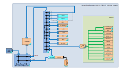

To be precise LPTIM2 is functional only in stop1 mode. As shown in the figure from AN5645
This is inline with the description in the RM:
Sorry for the confusion!

>>s it even possible? LPTIM2 is connected to a different bus than the other LPTIMs.
Indeed, in SRD, only LPTIM1, 3, and 4 are available:

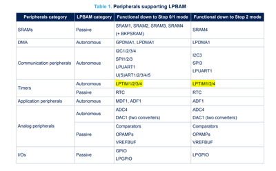

You can check the table of all the autonomous peripherals supported in stop2 mode in Getting started with LPBAM

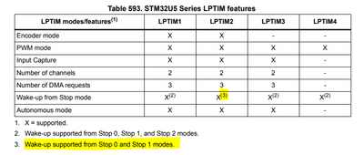

Is there an error in the reference manual (RM0456, page 2465) or how is the line "Autonomous mode" to be understood?

In the first table of your post, LPTIM1/2/4 are named for autonomous mode in Stop 2 mode.
Shouldn't that be LPTIM 1/3/4?
In the second table at LPTIM4 there is no autonomous mode available?
In relation to the table above, this would be a different statement.

Thank you @JoachimO
>>Shouldn't that be LPTIM 1/3/4? Indeed!
This typo should be corrected (Issue reported internally: Ticket 176652)
