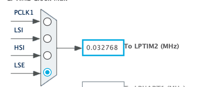

STM32WL LPTIM2 and LPTIM3 Not working
Hi
When LPTIM2 and LPTIM3 enabled with "Count Extenal Clock with internal sync" with LPTIM2 Global interupt Enabled, it is not calling void HAL_LPTIM_AutoReloadMatchCallback(LPTIM_HandleTypeDef *hlptim)
But LPTIM1 is working perfectly as expected , it is calling  HAL_LPTIM_AutoReloadMatchCallback(LPTIM_HandleTypeDef *hlptim)

 hlptim2.Instance = LPTIM2;
 hlptim2.Init.Clock.Source = LPTIM_CLOCKSOURCE_APBCLOCK_LPOSC;
 hlptim2.Init.Clock.Prescaler = LPTIM_PRESCALER_DIV1;
 hlptim2.Init.UltraLowPowerClock.Polarity = LPTIM_CLOCKPOLARITY_FALLING;
 hlptim2.Init.UltraLowPowerClock.SampleTime = LPTIM_CLOCKSAMPLETIME_DIRECTTRANSITION;
 hlptim2.Init.Trigger.Source = LPTIM_TRIGSOURCE_SOFTWARE;
 hlptim2.Init.OutputPolarity = LPTIM_OUTPUTPOLARITY_HIGH;
 hlptim2.Init.UpdateMode = LPTIM_UPDATE_IMMEDIATE;
 hlptim2.Init.CounterSource = LPTIM_COUNTERSOURCE_EXTERNAL;
 hlptim2.Init.Input1Source = LPTIM_INPUT1SOURCE_GPIO;
 hlptim2.Init.Input2Source = LPTIM_INPUT2SOURCE_GPIO;
 if (HAL_LPTIM_Init(&hlptim2) != HAL_OK)
 Error_Handler();
 /* USER CODE BEGIN LPTIM2_Init 2 */
 HAL_LPTIM_Counter_Start_IT(&hlptim2,PULSE_WAUP_COUNT);

In fact, the LPTIM1 can be configured to wakeup the MCU from STOP2 mode but the LPTIM2 & 3 can't wakeup the MCU from STOP2 mode. On the LoRaWAN_End_Node example, the #define LOW_POWER_DISABLE is set to 0 as a default value, that means the MCU can enter STOP2 mode. So, the LPM (Low Power Manager) will put the MCU to STOP2 mode on the sequencer IDLE task. If you want to use the LPTIM2 & 3, you have to set the #define LOW_POWER_DISABLE to 1 so on the IDLE task, the MCU is putted to SLEEP mode.

LPTIM2 & 3, is working with #define LOW_POWER_DISABLE to 1
