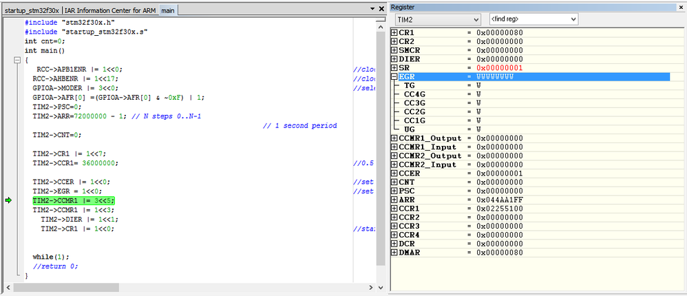

‎2016-06-11 12:01 AM
I noticed that when i try to set the UG bit in the EGR register, I can't do that but I don't know why it goes to modify the UIF bit of SR register, I'll add a pic of the situation after the TIM2->EGR = 1<<0; istruction.

clive1 thanks for the help, i solved it i was getting wrong because i written 3 instead of 2 in GPIOA->MODER (because 3 let me select analog function while i needed to select the alternate function) and i was using AF0 while i needed to use AF1, really thanks for your time :)
