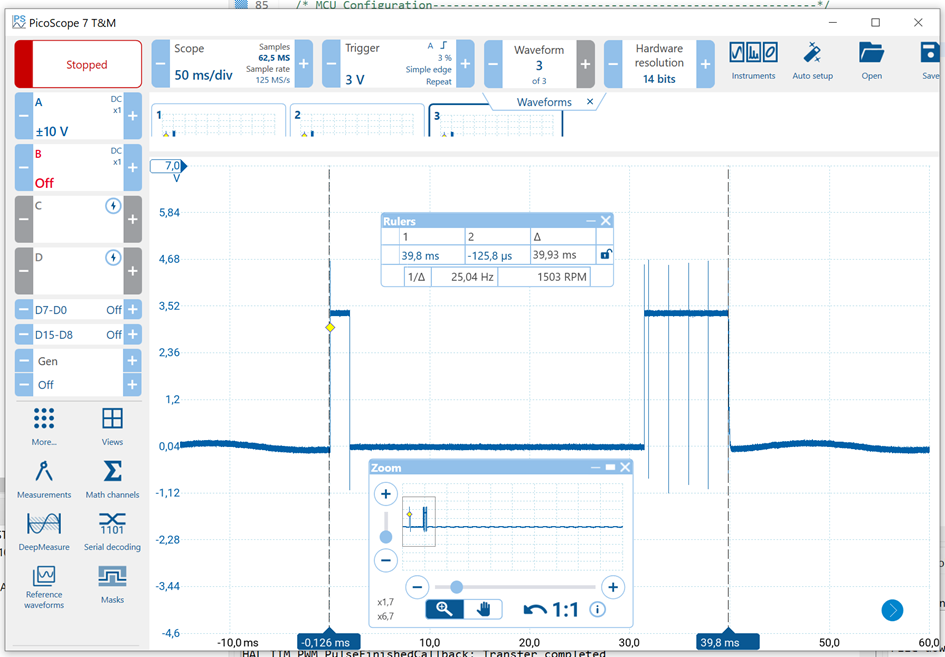

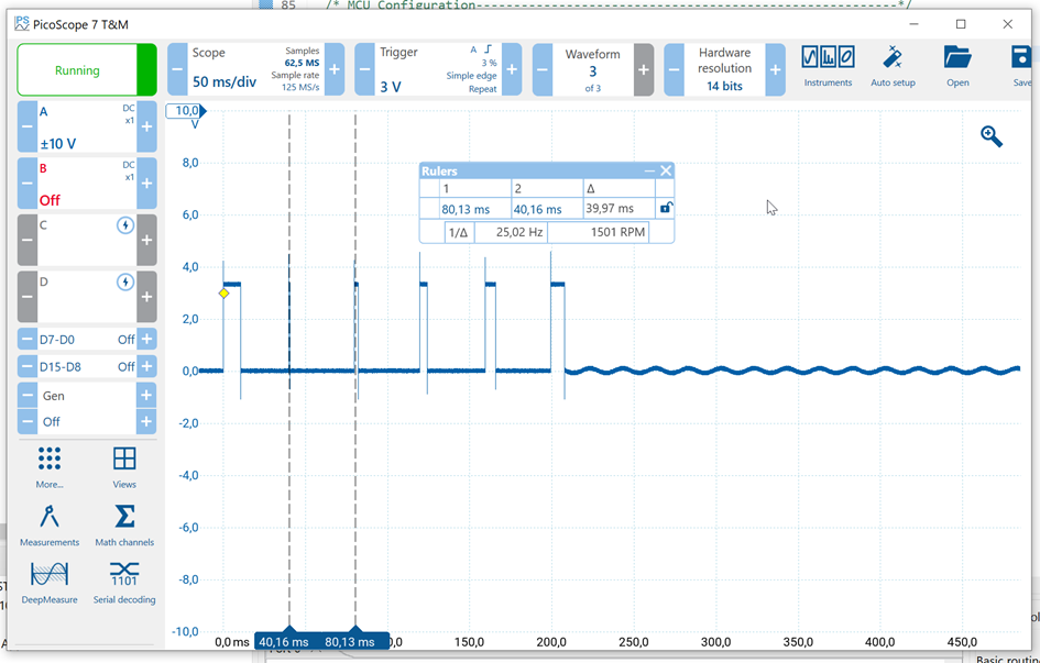

I am experimenting with PWM DMA on STM32F407VET6. The code creates pulses of increasing width.
If I enable the output compare preload, the number of pulses is 2 instead of 6.
The first pulse at startup is the default setting from the configuration in MX and not the first DMA value. This makes sense as preload of output compare means to load when timer = 0 (if I am not mistaken).
To make sure PWM values are not one off, I disabled the preload of the output compare register. In that case I get only 2 pulses and pulse generation stops? Why do I get only 2 pulses in that case?

_legacyfs_online_stmicro_images_0693W00000bida4QAA.pngEdit: It seems that the transfer complete interrupt is coming to early in the case without preload.
waclawek.jan
> how to make sure the first pulse is what the first DMA word sent specifies.

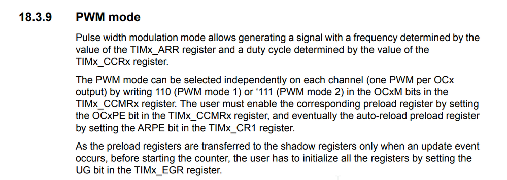

Before starting DMA, load the desired value into CCRx before setting preload, or with preload already set, generate Update manually.
You can generate manually events (including Update) by setting respective bits in TIMx_EGR.

If you'd use higher resolution on the oscilloscope - or just slower system clock - you'd see 5 pulses within that longer one, spaced closely apart.
If you want understanding, Cube is open source and you can look into it to see what it does - or just simply don't use it and write your own code, which you have full control of.
HAL_TIM_PWM_Start_DMA() sets the DMA request (trigger) to come from the CCx event. I don't know your pulse width values, but say ARR=1000 and the array contains 100, 200, 300: so, without CCx preload, when you have a CCx event at CNT=100, output goes low but DMA loads 200 into CCx which in turn makes output go high until CNT=200 when output goes low and DMA loads 300, so CCx goes again high until CNT=300.

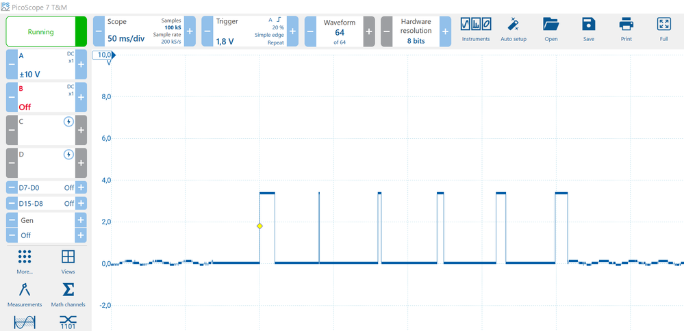

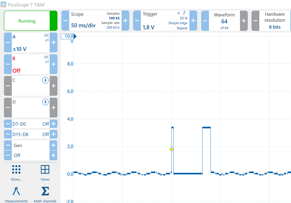

_legacyfs_online_stmicro_images_0693W00000bidvWQAQ.pngIf I disable output compare preload, the pulses are indeed very close to each other. I still wonder why. For sure it is not my timing setting that is at the origin of this weird result because if I enable preload, with the same settings I get the right result below.
_legacyfs_online_stmicro_images_0693W00000bidvbQAA.png(APB1 Clock is 40 MHz so Using pre-scaler the base of the timer is 2.5kHz,
The counter counts internally to 0-99 so the timer counts at 25 Hz or 40 ms period.)

Reading the datasheet, I already figured out that probably the timer seemed to start before the DMA value entered the CCRx. This seemed probable as the sheet indicated that preload was transferred to the operational register at the update event.
So tried to build a wrapper around HAL_TIM_PWM_Start_DMA and succeeded in fixing the first bug manually programming the first cycle manually and then let the DMA kick in. But then other annomalies started to show up leading again to abnormalities.
