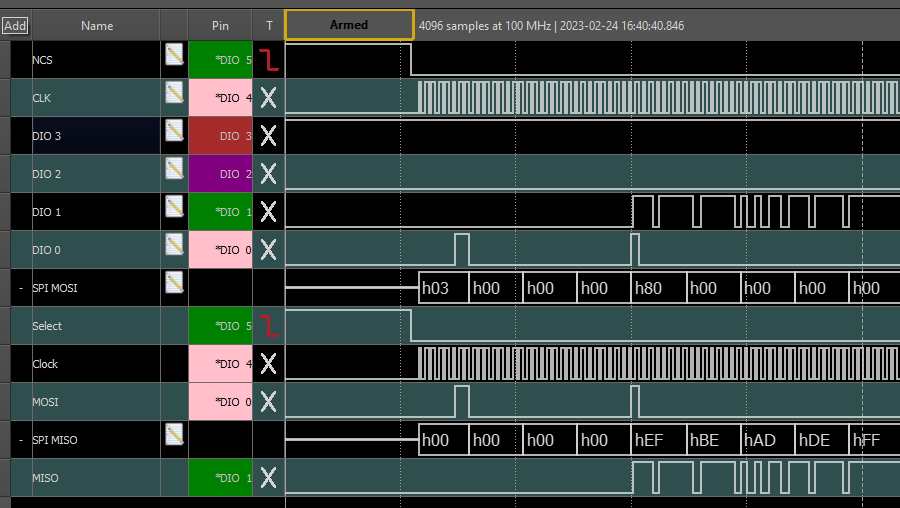

So firstly, I'll explain what I'm trying to achieve. My company is planning to utilize an STM32H7B0 because it's the chip that we were able to find stock of. For testing, I'm using a STM32H7A3 because it was available as a Nucleo board. The primary requirement we have is that updates to the device must have as little downtime as possible. Functionally this means that an update should be downloaded into a second image slot during normal operation, and then switched with as little downtime as possible. This would be simple using the H7B3 or H7A3, but we cannot find available parts.
My current approach is to use MCUBoot to load the image into RAM from a slot contained in a QSPI NOR flash. This also enables us to encrypt the image in the QSPI for IP protection. This is also the primary reason I'm not pursuing XIP. In theory this approach should work just fine, and I've already confirmed that the software runs just fine out of RAM instead of flash.
The problem I'm facing is in setting up a sane development environment. Currently, OpenOCD is configured to load the program into RAM which lets me test the program just fine. But I have to be able to write the program into the QSPI in order to test the bootloader. OpenOCD actually has a flash driver called `stmqspi` which will let me access the QSPI as another flash bank. However, I've only had limited success in getting this to work due to the memory mapped mode returning garbage.
The QSPI Flash I'm using is a Winbond W25Q16DV.

You might notice that this is configured for 1-lane for both data and address. This is because for some reason, the stmqspi driver is unable to probably fetch the SFDP parameters, device ID, or run commands in quad spi mode.
But in this mode, I'm able to erase, write, and read the flash via raw commands. But the memory mapped region just returns "garbage". I mean, it's close?
> stmqspi cmd 1 4 0x03 0 0 0
spi: 03 00 00 00 -> ef be ad de
> mrw 0x90000000
0xefddeafb
> mrw 0x90000004
0xffffffff
Even more confusing, the signals coming back from the memory mapped operation look completely fine:
0693W00000aHdsAQAS.pngAm I missing something obvious? Do I need to explicitly disable cache? I'm just really lost here.

The Dummy Cycles DCYC=4 is causing the shift in the Memory Mapped data, READ (0x03) has no dummy cycles
