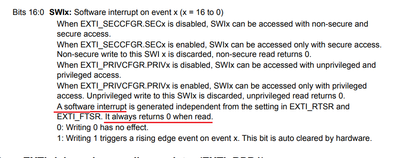

I try to use a software interrupt with no secure and no privilege.
when I set a bit in EXTI_SWIER1 And re-read the register, the value stay to 0.
When the interrupt was fired, It's impossible to distinguish the software interrupt from external input.
On the F4 series the EXTI_SWIER1 contained the bit who call the interrupt.
Is it another methode to do that ?
Regards

Hello @lozzz and welcome to the community,
This is what the reference manual of the product says for SWI bits in EXTI_SWIER register:
‎2024-12-12 8:03 AM

In that case, how can distinguish the software interrupt from external input in the EXTI handler ?
Regards
‎2024-12-12 8:06 AM - edited ‎2024-12-12 8:07 AM
Maybe try to read EXTI_RPR and EXTI_FPR registers and check if one of the bits for a given EXTI line is set. If none of them are not set it came from software.
‎2024-12-12 8:20 AM
The thing is on the EXTI_RPR the bit is set on software interrupt, like the external input.
