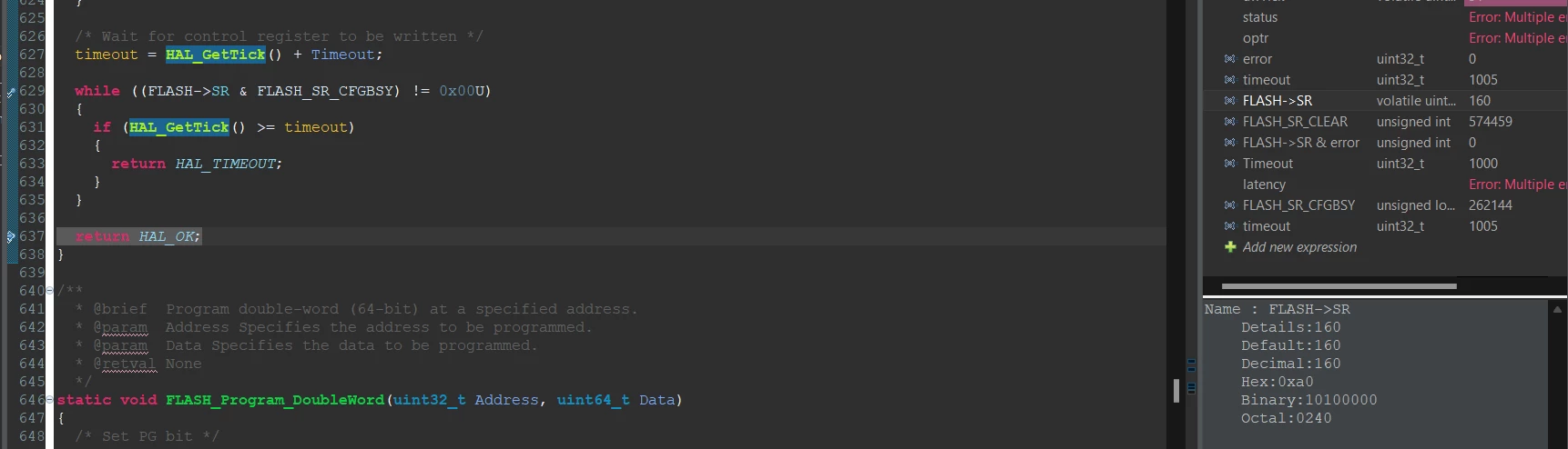

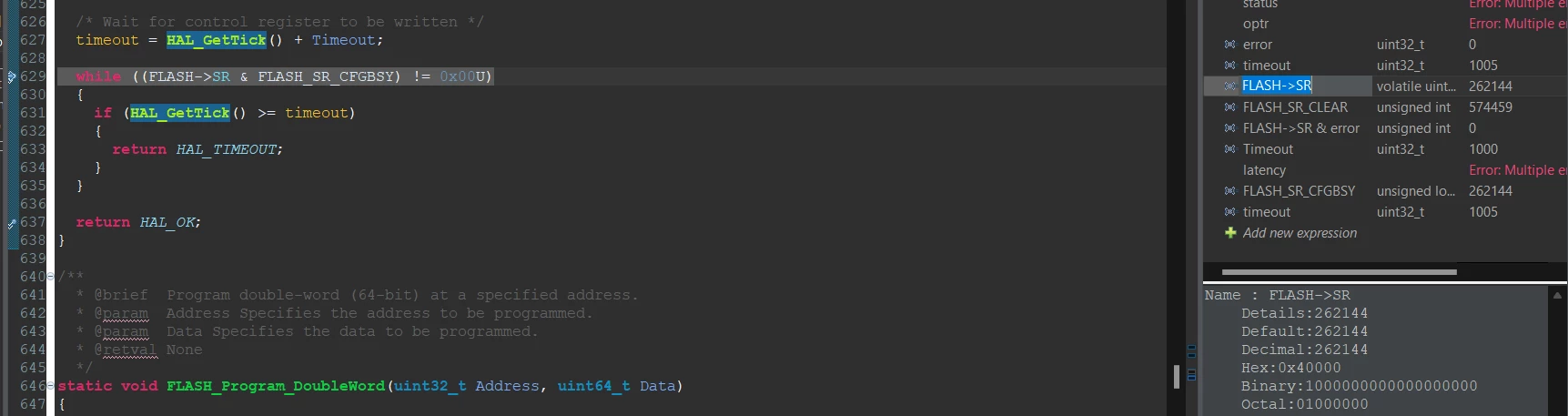

Okay, you're right - these bits was set before run functions. But if i cleared that, program returns HAL_ERROR from second FLASH_WaitForLastOperation() in:
#endif /* FLASH_SECURABLE_MEMORY_SUPPORT */
 /* Wait for last operation to be completed */
 status = FLASH_WaitForLastOperation(FLASH_TIMEOUT_VALUE);
 if (status == HAL_OK)
 /* Set OPTSTRT Bit */
 SET_BIT(FLASH->CR, FLASH_CR_OPTSTRT);
 /* If the option byte program operation is completed, disable the OPTSTRT Bit */
 CLEAR_BIT(FLASH->CR, FLASH_CR_OPTSTRT);
 /* Process Unlocked */
 __HAL_UNLOCK(&pFlash);
 /* return status */
 return status;
Also PGA and PGS....
I checked when its was set to 1(these flags was cleared in prevous wait)- and it was set in this while loop in previous wait, whitch is chegking only 18th bit:
 while ((FLASH->SR & FLASH_SR_CFGBSY) != 0x00U)
 if (HAL_GetTick() >= timeout)
 return HAL_TIMEOUT;
before loop:
after loop:
Dthum.1
