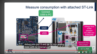

I am using X-NUCLEO-LPM01A to measure some currents on P-NUCLEO-WB55 according to video:
https://www.youtube.com/watch?v=7IVs-nuoXj8.
To keep ST Link enbaled the commentator asks to put some pins to analog state , no internal pull-up , and pull-down state
See here:
How do I do that?

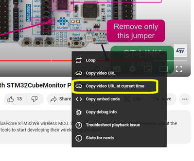

You can link to a specific time in a YouTube video:
eg, https://youtu.be/7IVs-nuoXj8?t=736
I think you may have misunderstood what he meant: that will still break the debug connection - it just saves you having to physically fit & remove the jumpers.
Also, if you're trying to get your application down to really the lowest possible current level, this will still leave some leakage - so you'll still need to physically disconnect.

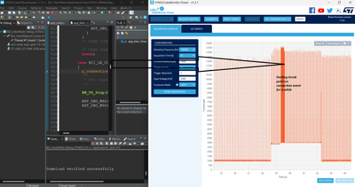

Prior to adding PIN13 and PIN5 to be analog, I Ran a quick test , programmed the WB55 in debug mode (CubeIDE) , and ran.
Have some weird base current of 1 mA on advertising during sleep.  (BleHeartRate example)
But then,  I do get to hold a breakpoint on connection event  , debug doesn't break. But I see the current jump high to 3mA while I am holding the break point. here:

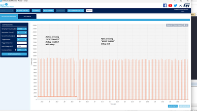

Exiting debug:
Pressing the" Reset button" on WB55 does not exit debug.
Only if I press "RESET TARGET" on STM32CubeMonitor-Power than I lose it. And only then I see datasheet sleep currents. (3uA). See here:
So what's going on? and what is then the correct way to keep debug with sleep if I need it?

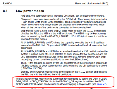

@DS.4 wrote:
"that will still break the debug connection" - why?
Because you are disconnecting the SWD connection - which goes through those pins.
You will never get true low power readings with a debugger connected - the debugger keeps the CPU awake.

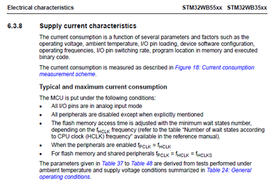

Current consumption figures are given in the datasheet:
As it says, the consumption depends on many things - and not just the physical characteristics of the chip but also the nature of the particular application (hardware & software).
So it's really not possible to give a simple statement, "current consumption is X".
