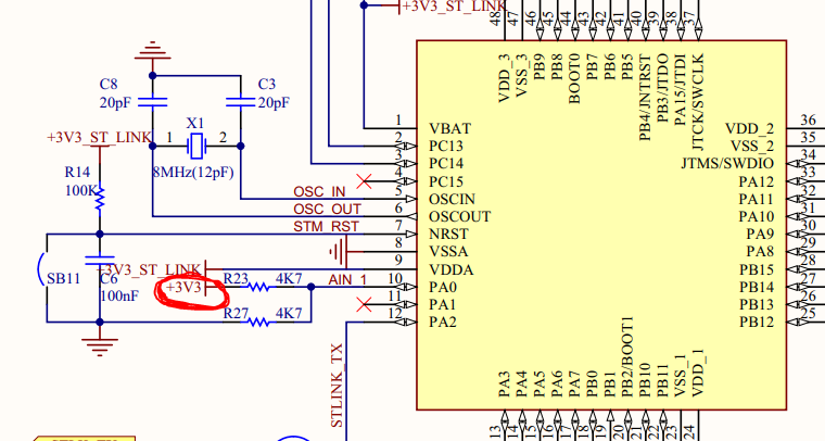

I tested the solution this external power supply 3V3. (programming with STLink doesn't seem possible in this configuration [SB12 OFF] ).
With the same ampermeters I get IDD = 0.6 uA (I don't know why it doubles up). And i measure 0.40 mA for the total current. It is much better than the 50 mA but there is still 400uA going somewhere.
The only current path going from 3V3 and not passing though JP6 i can find is one:
I measure 1.9 V at R23. It gives a current of 400uA. Since i don't need STLink, maybe i could remove R23 and thus delete those 400uA?
