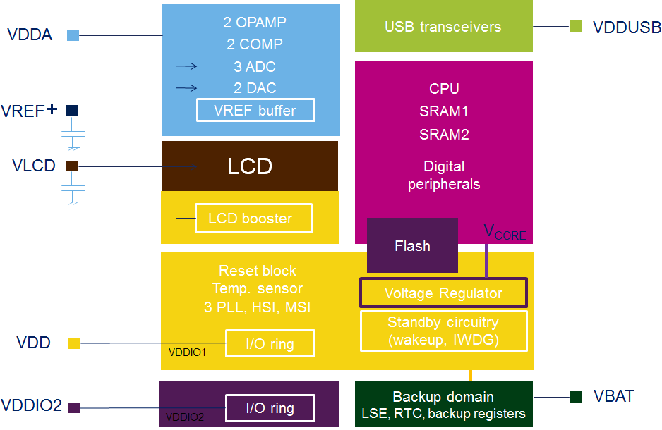

Posted on August 03, 2017 at 22:12
Start from looking at the STM32L4 family. It has separated USB, VDDIO1 and VDDIO2 supplies which would enable a rich mix of diverse supply voltages to coexist. For each group of GPIO supply voltage there are the usual serial interfaces suspects. This way, external voltage shifters might be avoided.

Posted on August 03, 2017 at 22:22
Hello Andy,
Looking at the requirement:
I need the board support USB port as USB device, and run the GPIO on 1.8v
it seems to me that maybe STM32L4 can be an interesting solution for you. STM32L4 in packages with big amount of pins (LQFP144, BGA132, CSP72 and CSP81) have VDDIO2 domain. This domain has a dedicated supply pin, which level can be in range of 1.08 ? 3.6V, comparing to VDD 1.71 ? 3.6V and VDDUSB 3 - 3.6V. VDDIO2 domain supplies only pins from GPOIOG, while VDD supplies rest of the GPIOs. With this solution you can easily get a voltage level tranlator or pins operating on different voltage levels.
Regarding the evaluation boards with STM32L4: you can use
http://www.st.com/content/st_com/en/products/evaluation-tools/product-evaluation-tools/mcu-eval-tools/stm32-mcu-eval-tools/stm32-mcu-nucleo/nucleo-l496zg.html
, as it offers STM32L496 in LQFP144 package. Unfortuantely VDDIO2 on this board is connected to VDD, so you would need to cut a wire and make hardawre modification on your own.

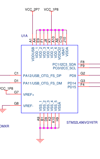

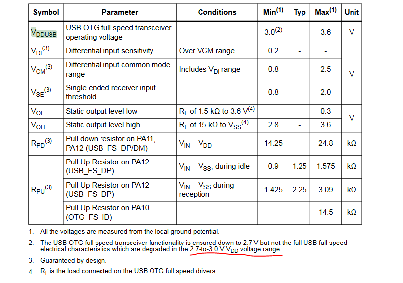

Posted on May 14, 2018 at 14:25
Hello Szymon
Panecki.Szymon.002
I am in similar situation With STM32L496VGY. I am trying to operate VDDUSB @ 2.7V (I can increase upto 3V). But All other VDD (Including VBAT,VDDA,VREF+) @ 1.8V. From the datasheet I found a statement saying that ''The USB OTG full speed transceiver functionality is ensured down to 2.7 V but not the full USB full speed electrical characteristics which are degraded in the 2.7-to-3.0 V VDD voltage range''. Which VDD datasheet is referring to is it VDDUSB or all other VDD(Including VBAT,VDDA,VREF+). If that the case do i need increase the VDD(Including VBAT,VDDA,VREF+) to 2.7V to make USB working.
http://www.st.com/content/ccc/resource/technical/document/datasheet/group3/3f/73/19/d1/d4/9e/48/34/DM00284211/files/DM00284pdf/jcr:content/translations/en.DM00284pdf
Voltage Distribution Schematic
Posted on May 14, 2018 at 15:50
PA11/PA12 don't meet USB electrical specs below a 3.0V supply. I'd assume the ramification there would you couldn't get USB certification, and attachment would be problematic across the installed user base. I generally prefer that the tech support staff don't want to murder me or poison my coffee.
Posted on May 14, 2018 at 16:04
Hai Clive
Its seems there is less clarification on mixing up different voltage on STM32MCU. Anyway I am willing to accept USB function with degraded performance.

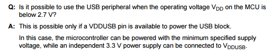

Posted on May 16, 2018 at 11:27
Hello Jismal Jamal,
Thank you for designing with STM32L4 MCU. If you want to use USB, then you need to keep VDDUSB on at least 2.7V, while rest of VDD pins can be supplied with lower voltage, for example 1.8V, which you mentioned.
Statement, which confirms this can be found is ST documentation: application not
http://www.st.com/content/ccc/resource/technical/document/application_note/group0/0b/10/63/76/87/7a/47/4b/DM00296349/files/DM00296349.pdf/jcr:content/translations/en.DM00296349.pdf
. Please see the extract below:0690X0000060Kn5QAE.png
Regards
Szymon
Thank You Szymon. The project was a succesfull one, USB work as intended.
