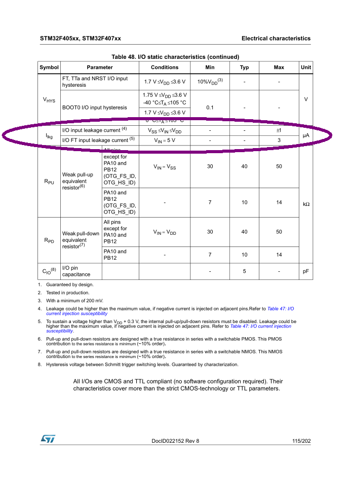

Posted on January 22, 2018 at 14:46
all I/O pins are high impedance
How high is high ? Can you put a number to quantify the impedance ?

Posted on January 22, 2018 at 16:12
Thanks !
I was looking for 'impedance', 'Ohm', 'Ω' and similar keywords, not 'current'.
So, we're talking about MΩ impedance, which isn't particularly high. I have voltage dividers in the same order, having one connected to such IOs will be impact the circuit.
