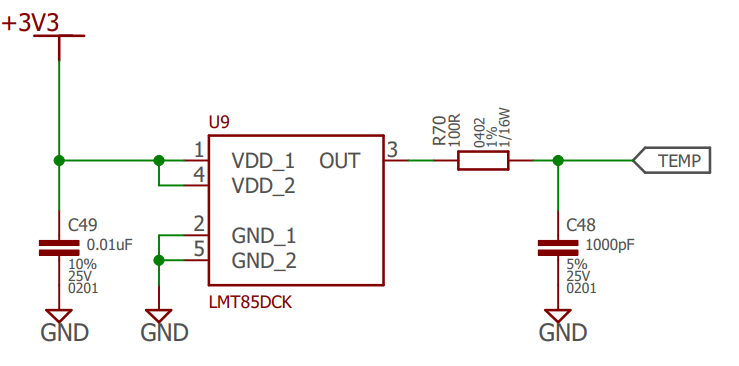

Can you share the code and tell us what pins you are trying to use? What is the source of DC voltage you want to measure. How did you wired the pins (pot or resistor divider, etc)

I've updated the question with the code. Some of the pins I've just been manually shorting to VCC (3.3) or GND, but PA0 is connected to a temperature sensor like below which is putting PA0 at 1.3V roughly. If multiple ADC channels are configured how do I know which one I'm converting when I receive the interrupt?

Posted on January 22, 2018 at 16:50
The difference was the VREF+ pin. VREF+ and VDDA are not double bonded on the 100LQFP package and since VREF+ was not connected externally in the design it was not being powered. Adding the below code fixed the issue:
