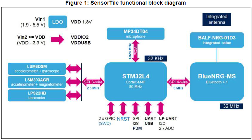

I have a
STEVAL-STLKT01V1 Sensor Tile. I want to add additional sensing capabilities and was wondering how to add a peripheral that communicates over I2C? Are there any firmware examples of how to do this?

From UM2101, ''Getting started with the STEVAL-STLKT01V1 SensorTile integrated development platform'':
http://www.st.com/resource/en/user_manual/dm00320099.pdf
See:
http://www.st.com/en/evaluation-tools/steval-stlkt01v1.html
Just looks to be a standard I2C connection - so any of the STM32 I2C examples should do?
