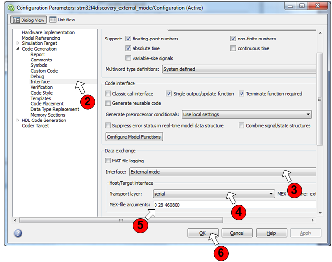

The problem is that now I want to switch to ''external mode'' so that I can read the information processed by the microcontroller in real time, but I can't see the ''EXTERNAL MODE'' option displayed under the ''GPIO I'' text. I neither can see the ''Operating system options'' gropubox that should be located at the top of the window.

Ok, it seems that everything was ok. The thing is that in this version those options do not appear and the configuration of the serial port must be done as shown below.
This is an image from the tutorials that come with the instaled stm32f4-discovery package for simulink. It is slightly different as you can see from the online tutorials that you can find in MATlab web page.
