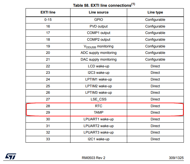

Hello together,
I'm a little bit confused by the NVIC and EXTI description in the RM0503.
The NVIC vector table says the RTC / TAMP interrupts are combined EXTI lines 19 & 21 (on page 302).
But when looking at the EXTI line connections table (on page 309) the RTC source is on line 28 and TAMP on line 29.
Solved! Go to Solution.

‎2024-11-21 10:45 AM
This is already reported here with other issues: Missing section IRTIM in STM32U0 RM and more.

‎2024-11-21 11:07 AM
Hello @christian-enderle
Thank you so much for reporting this typo. I will escalate it for correction on the comming releases of the doc.
@AA1 i will be back and take a deep look to your comments and escalate all typos. Thank you so much for your contribution.
Best Regards.
