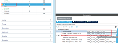

If I would likes to use only the SMS I can modified:
HAL_PWREx_ConfigSupply(PWR_DIRECT_SMPS_SUPPLY)
but I don't see this option for the  NUCLO-H755ZI-Q on the cube menu. can I set it manually?
In this case the hw changes will not be needed... correct?

The NUCLO-H755ZI-Q board is in SMPS configuration.
The power configuration can be set in RCC menu:
Attached an example of .ioc file for this board.

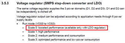

Warning 1: in SMPS mode you cannot exceed a system frequency of 400MHz/VOS1.
You need to set VOLTAGE_SCALE1 in this configuration.
According to the datasheet:
Warning 2: the software power configuration you load to the MCU should reflect the HW power configuration of your board, otherwise the MCU will be temporarily "lost" and you need to recover the chip by a specific manipulation.
