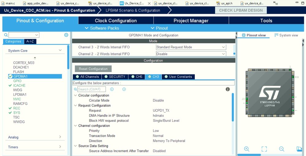

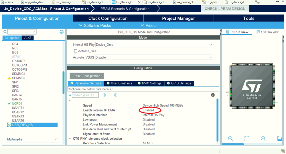

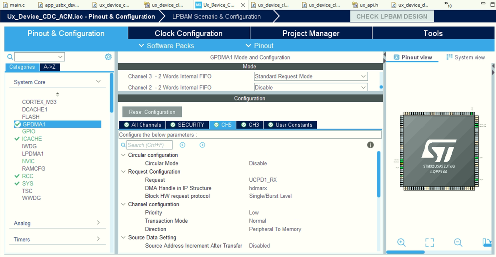

‎2024-02-07 2:53 AM
@FBL Thanks for the reply. I have managed the hard fault handler issue in my code and now the ux_device_class_cdc_acm_write_with_callback API in non-blocking mode works successfully. But the speed is now reduced to 3 MBPS from 5 MBPS of the blocking mode API.
I have also tried by enabling the internal IP DMA in the configuration. Below attaching the screenshots of ioc configuration for DMA. The GPDMA configuration was already from the example project.
DMA enable
DMA Rx channel
DMA Tx channel
After enabling the DMA in ioc, the write function _ux_dcd_stm32_transfer_request failed to send the data over USB and it is waiting for a semaphore,

OTG_DIEPDMAx/OTG_DOEPDMAx register in peripheral mode) to access the data
buffers. (page 3390)
So, as I understand:
- USB has a dedicated (different) DMA (USB Host has its own DMA engine)
- and this DMA can be enabled in USB Host mode (only) (all about DMA on USB is related to Host)
But USB VCP UART is a USB Device. So, I assume, USB does not use a DMA for VCP UART transfer (in both directions).
It has FIFOs and INTs, which should be still fast enough for a good throughput.
