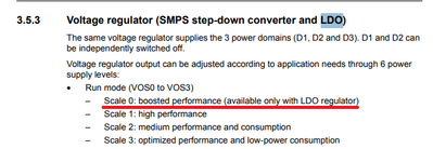

PS: in the product datasheet it was said that LDO is only available in boosted performance mode. Boosted mode is where the system clock is > 400Mhz at VOS0:

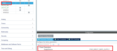

What power configuration you set for that NUCLEO-H755ZIQ? you need to set the power as Direct SMPS otherwise you break the MCU. The default power mode for that board is Direct SMPS.
As the following:

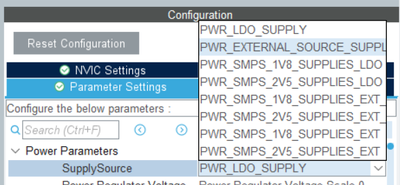

I don't have that option available. I can't remember which of the many features I enabled caused a conflict, but it has disappeared from my valid options. These are the only ones I have left, and LDO is currently selected.
Because most probably you have set the system clock > 400Mhz.
Direct SMPS is only available at System frequency <= 400MHz (VOS1)
So set the system clock at 400MHz and Direct SMPS option will appear.
Yes, I configured the system clock to its maximum frequency of 480MHz.
