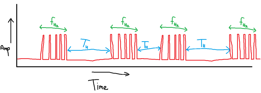

Hello All,
I want to generate a different type of PWM along with its phase shift PWM as well. Below is the diagram for the output waveform. I am using the NUCLEO-F030R8 board as of now.
Where Fhz and Th are the same for all instances as shown on the image, they also need to be changed on run time.
Waiting for assistance.

I don't know what's "phase shift" in this waveform, but one way how to generate such waveform is to run two timers in master-slave interconnection - slave would generate output using PWM at the higher fHz frequency; master would generate PWM (without outputting it to a pin - unless you want to check it) which determines the "envelope"; slave would have set the slave-mode controller in TIMx_SMCR in Gated mode.

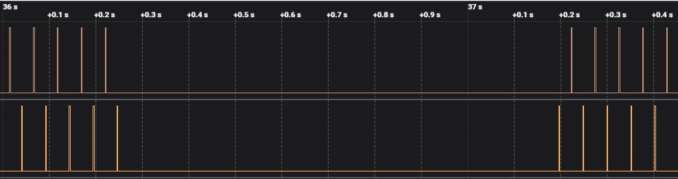

_legacyfs_online_stmicro_images_0693W00000dJvcfQAC.pngSo actual wave which I am trying to generate is similar to this.
Where the frequency and duty cycle are the same only difference is a phase shift.

I still don't understand: you want to generate both signals on two pins of the STM32? And the phase shift is variable somehow? Also, there lower signal on the left-hand side is shifted to the right, whereas on the right-hand side is shifted to the left, or there is one more pulse within the bunch, can you comment on that?
At any case, you should start with generating one of the signals, as I've described above.

@Community member the image which i attached is cropped and is just to represent what i ment by phase shift. Let me clearify that yes it is just shifted a bit.
Nop I am not able to generate the any of the single. But i am able to generate a continuous PWM that's it.
(Note: it is just a cropped image and just for representing purpose it is not the exact one.
