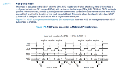

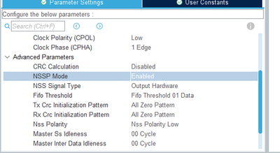

This is a question related to SPI communication.
What is NSSP mode? What does it do?
Also is there any documentation that explains all parameters in detail other than this

Hello @sreyas40
Please refer to the description below in the RM0529:
