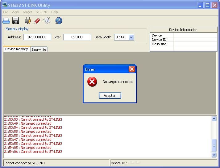

Posted on March 23, 2011 at 22:03
with the STM32 ST-LINK Utility also don't work. Where is my problem?
The problem is the WinXP? The St Drivers? ...
Thanks!
Posted on March 24, 2011 at 07:37
Dunno, perhaps your ST-LINK is busted, try it on a different PC.
If this is a VL discovery, do you still see the ''flash drive'' instantiation with the webpage/links to the documentation files when you plug it in.
Does your account have administrative rights? Do you have some AV software that might interfere with normal operations?
