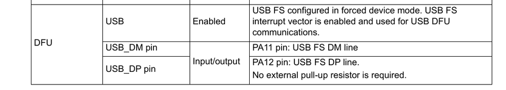

‎2025-01-15 10:57 AM
From AN2606 , for F070x6 :
..so no 1k5 needed ! (remove it.)
