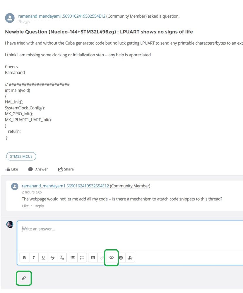

I have tried with and without the Cube generated code but no luck getting LPUART to send any printable characters/bytes to an external TeraTerm terminal over VCOM.
I think I am missing some clocking or initialization step -- any help is appreciated.

int main(void)
HAL_Init();
SystemClock_Config();
MX_GPIO_Init();
MX_LPUART1_UART_Init();
   return;

The webpage would not let me add all my code -- is there a mechanism to attach code snippets to this thread?
Ok, so you can edit posts, and you can add code with the </> icon, and also as attachments.
If the pins are on Port G, you need to enable the VDDIO
