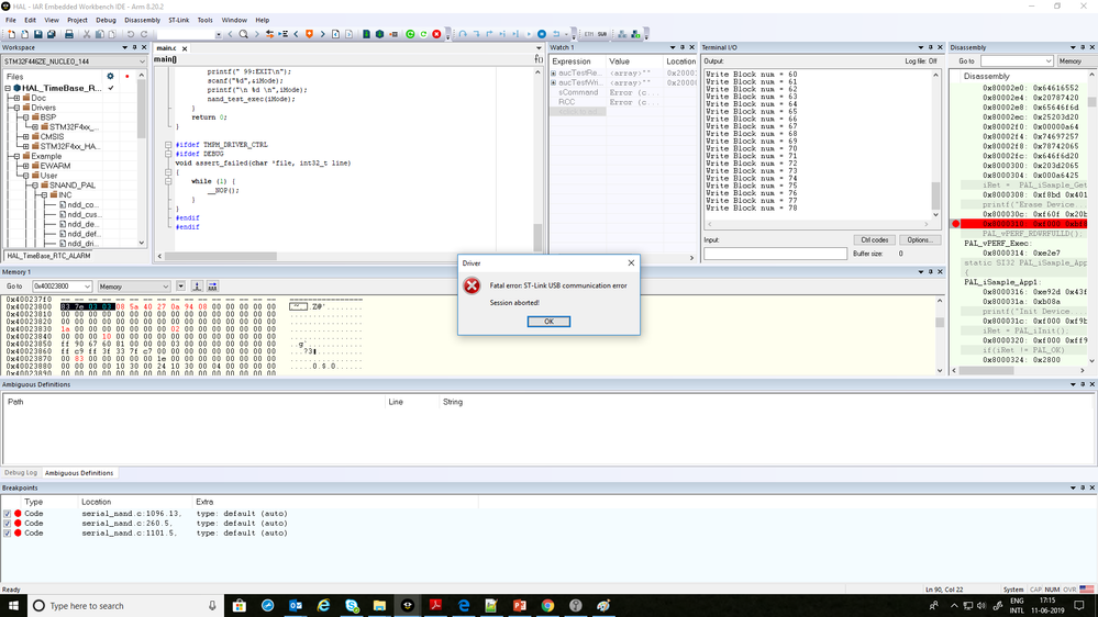

FA.11
0690X000008iTPsQAM.pngDear ST Community
We are able interface Serial NAND device with QSPI Controller on STM32F446-ZE nucleo board. we are able to do basic read and write operations.
Working Environment -> IAR work bench
We are facing following Issue:
If we run our test application approximately 30 min on STM32F446ZE board, we are getting Fatal Error: ST-Link USB communication error
Please address the above issue it is blocking for our product development as well to purchase of many new STM32F446ZE board.
Image is attached for your further reference
Regards,
Franklin
Have you tried your local FAE servicing your account?
Perhaps you can use a logic analyzer to see if it is hung up of a QSPI transaction, or way-point flow via GPIO output.
Loss of debugger connectivity in this context relates either to a loss of power (low power state), or some kind of dead-lock on the internal bus.
If you output telemetry via SWV/USART are you able to see any consistency with the loss of connectivity.
Does the system lock outside of the debugger?
