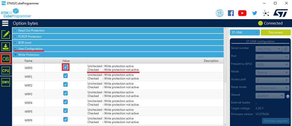

I need to run my code (it is a small code) from internal RAM. It currently runs from the first sector in the flash. For some reason, I need to change a few bytes in the same sector and it seems I can't write to the same sector from where the code is running (I wish I could) so I plan it running from RAM so that I can change those bytes.

I suspect the write protection is active. You can use STM32Cube Programmer to check the flash memory sector and disable the write protection as shown in the attached figure.
Also, for more details about option bytes and write protection you can refer to STM32F4 reference manual, section "3.4 Flash option bytes" with focus on "3.4.4 Write protections".

I am taking care of unlocking the flash and locking it after writing. I can write to other sectors (from where I am NOT running). So writing to flash works just not in the sector I am running from. So I want to run from RAM and do the writes. I need help with some linker files and init code that does it.

I am able to execute code from RAM. At the startup, Reset_Handler function copies entire flash code to RAM and executes from there but I am still not able to write to the first sector (from where the code was copied to RAM). I can write to other sectors. Why should that be the case?
