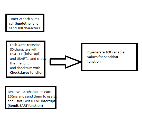

Something is driving me crazy.
Actually I have written a program that
it:
receive 100chars each 60ms from USART1 and 2 with RXNE interrupt(baudrate 57600)
receive100chars each 100ms from Ethernet with PHY and after processing it sends to USARTs port with TXNE interrupt
sends 120 chars to PC via Ethernet each 100ms with Timer.
it works fine when I connect my board via st-link in debug mode but when I get off out of debug mode it works for 1-2 hours and suddenly hangs and disables Ethernet communication.In this states I can't realize what  my problem is.
what is your idea about this strange states? why it works fine in debug mode?
Thanks in advance

And here is my network config
    netInitialize ();
    sock_tcp = netTCP_GetSocket (tcp_cb_func);
    if (sock_tcp >= 0) {
      netTCP_Listen (sock_tcp, 4050);
    netTCP_SetOption (sock_tcp, netTCP_OptionTimeout, 10);
uint32_t tcp_cb_func (int32_t socket, netTCP_Event event,const NET_ADDR *addr, const uint8_t *buf, uint32_t len) {
   switch (event) {
    case netTCP_EventConnect:DataAvailable=0;return (1);
    case netTCP_EventData:DataAvailable=1;Len=len;memcpy(Message, buf,len);netTCP_ResetReceiveWindow(sock_tcp);break;
  return (0);
and In the man project I only check if DataAvailable=1 then send Characters with USART
    if (USART_GetITStatus(USART1, USART_IT_TXE) != RESET)
            if(Count<=130 && Transfer==1){
                if(Msg[Count]=='\0' ){USART_ITConfig(USART1, USART_IT_TXE, DISABLE);Transfer=0;}
                    USART_SendData(USART1,Msg[Count]);
                    Uount=Count+1;
            else
                    Transfer=0;
All my variables that I think that I maybe use them in ISR I declared them volatile and I use keil without any optimization. I will check again my interrupts with different LEDs.

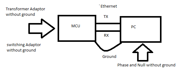

would it be possible that ground wire between Ethernet and my board cause a problem during process?something like this:
and Dear max thanks for you tip that I never pay attention to them before. is it possible how can I define for my MCU(stm32f10x)?
Thanks in advance
