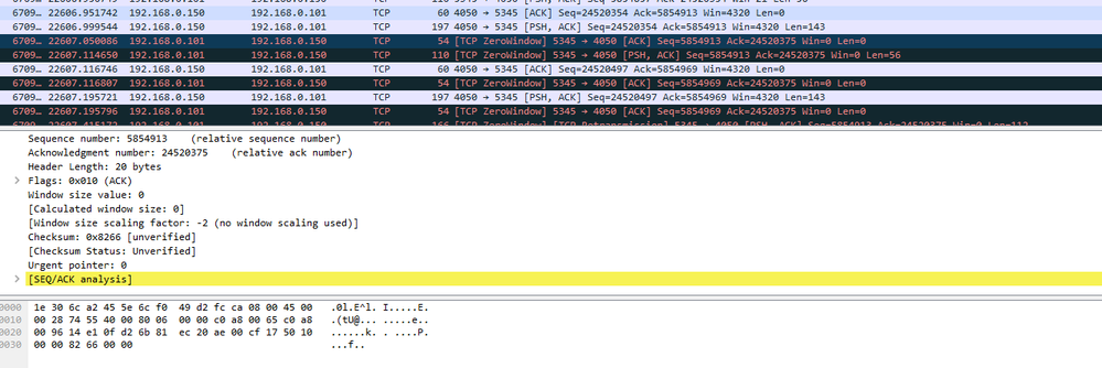

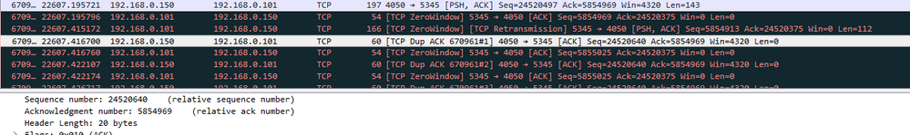

parisa
Senior
Posted on May 01, 2017 at 13:32
Thanks for your response and sorry for my long delay.
I have found something interesting with my communication, according to dear Clive one,Avatar and KIC8462852 EPIC204278916 I check different parts of my code and I see this error in my PC with wireshark program.
It shows me that my device (IP 150) 's TCP window has been zero however I clear TCP windows each time That I receive any new data.
uint32_t tcp_cb_func (int32_t socket, netTCP_Event event,const NET_ADDR *addr, const uint8_t *buf, uint32_t len) {
   switch (event) {
    case netTCP_EventConnect:Ether.DataAvailable=0;return (1);
    case netTCP_EventData:Ether.DataAvailable=1;Ether.Len=len;memcpy(PCSTR,  buf,len);netTCP_ResetReceiveWindow(Socket);break;
  return (0);
But why it becomes zero?
